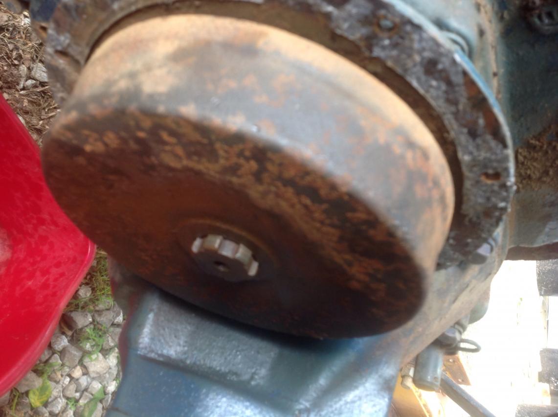

I just bought an L1500 last week and while driving it i realized the brakes were not working well and after a closer inspection a threaded rod connecting to brake system was bent and broke. I can't find parts or an owner manual, any help would be greatly appreciated. Rory

30,125
6,296
Post a picture of the brake set-up and we can try and see what it crosses with.
If it's the style of brakes I think it is:
Did you take the drum off?
It comes off with a circlip on the shaft.
shoes should be just held in by springs
