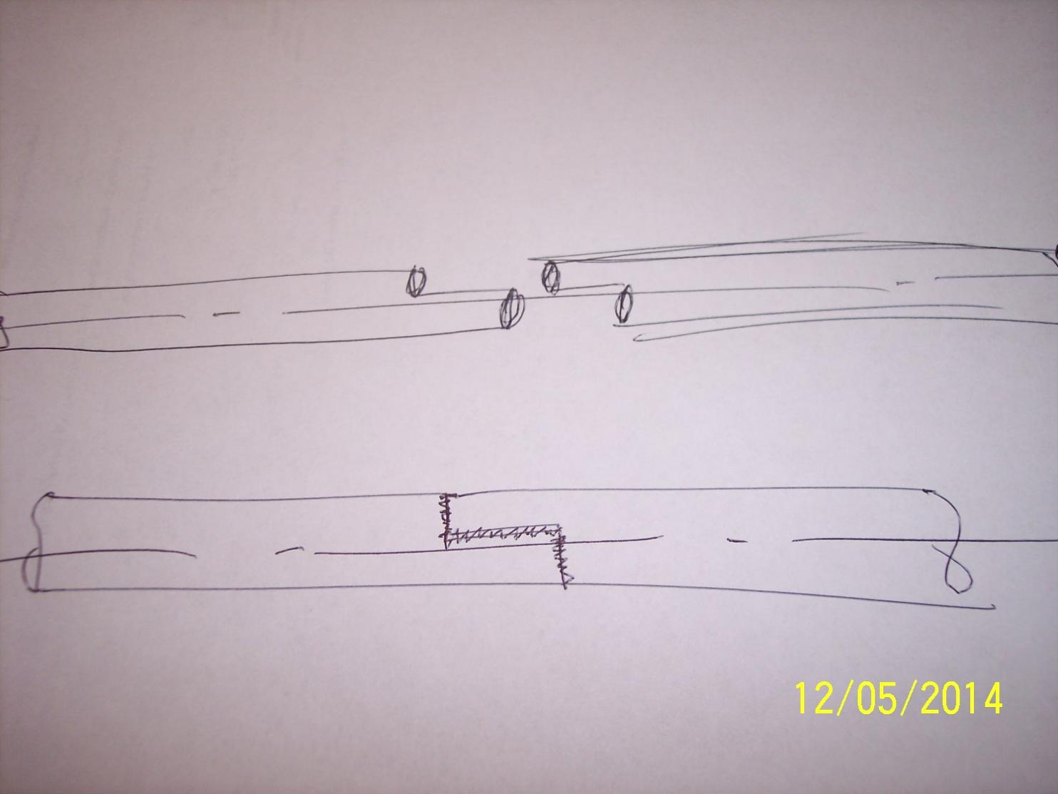

You mentioned cutting and welding. If you have those skills and tools why not get a metric bolt of the correct size and thread. Then cut off the threaded end of both the new bolt and the old and weld the new to the old?
To make a good weld on a round shaft grind the two opposing ends back (in this case about 1/2") on half of the diameter. Set the two parts up in a vise and weld all the way around the offset.

Just don't cut them and weld them straight across. Get the length you want with the old and new laying up to each other. Then grind a flat spot on the side of each piece (1/2") and match that up to weld. You'll get much more engagement.
Wish I could explain it better or draw a picture but.....

Threads of the nut have been chased with a tap. Thx wolfman. D2cat - still a bit confused on
how to grind. R u saying flatten two sides and weld across or chamfer the two side pieces and weld shut?

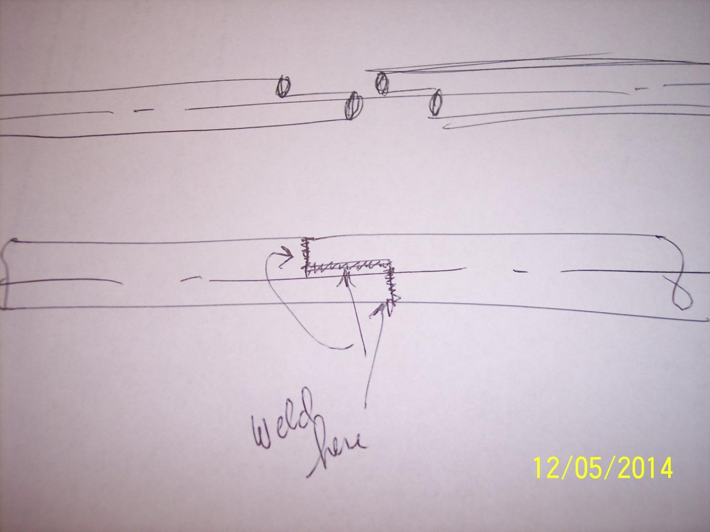

Maybe I can get this sketch to you.
Grind down to about center line of each part (half way through it). It's not critical just easier. Lay the two parts together in a piece of angle iron, or your vice to keep it were you want it. Use a straight edge to confirm it is straight after a tack or two before you weld it all the way around. If you chamfer the edges you'll even have more surface to weld to, and get a better weld.

Pictures are worth a thousand words. I totally get it now. I thank you for your effort. I have a grinding wheel and bench grinders and welding clamps to hold the pieces down. Should not be a problem.

Grind small bevels on those cut lines so when put together it leaves a void like a "V" shape. Then weld. You'll get better penetration and more fill material helping to bond the base metals. Don't make it too deep, you need about as much base metal as weld fill when you are done. You'll have to grind it back round after that but like D2Cat shows, it will be solid.

When I butt weld two cylinders together I bevel both ends to nearly a point, then weld all around and dress back to original diameter. Same as you'd do with proper prep for any butt weld. Gets 100% fusion and fill this way. Laying the pieces in a piece of angle iron helps keep them coaxial.
