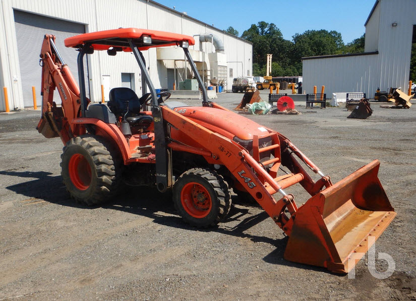

L 45 2016 Hood Release?

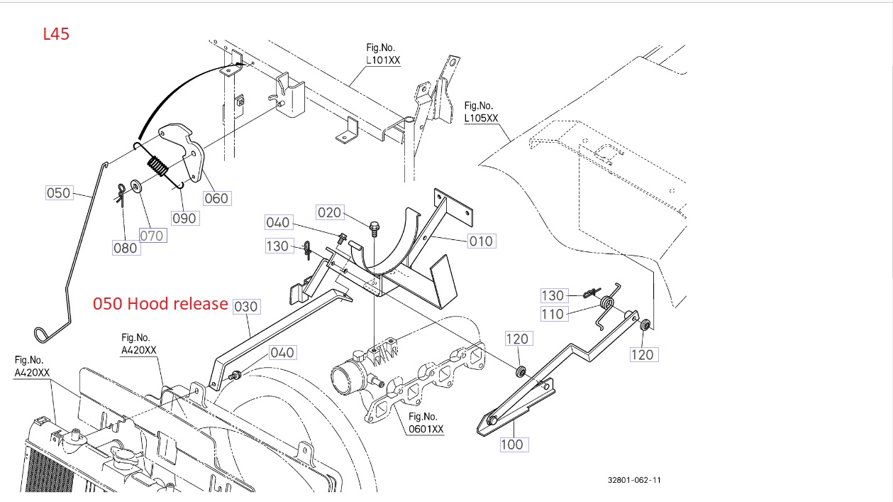

There’s likely a release for the grille guard also. If you release the hood and it won’t raise because it’s hitting the grille guard you’ll need release the grille guard to tilt it forward. If it has one the grille guard release should be on the same side as the hood release at the base of the grille guard. Should be pretty obvious. The hood release wire may be less obvious as it’s a bit down under the bottom of the hood.
