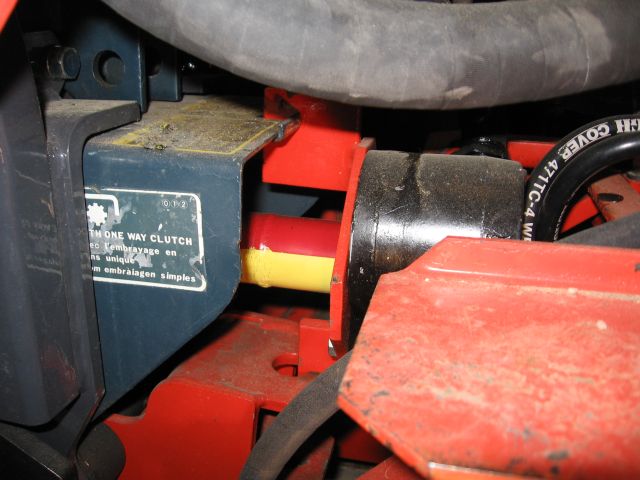

On my backhoe the pump is held on the PTO shaft with a pin that you need to push to get it to release. Similar to a PTO drive shaft to an implement. If there is no obvious release pin or collar like Birdogger was talking about it probably has a roll pin in a hole that goes through the shaft. If the backhoe has not been off in a while it could be hidden by oil/grease or mud. Next- the pump is only supported by the shaft and you can see it move slightly as the shaft rotates. There should be some method to keep it from spinning. Mine has a pin that sticks up and goes into a slot on a bracket just above the pump. It does not hold the pump firmly just keeps it from spinning. I have seen other setups that use a spring and cable to keep the pump from spinning.
Can't really help with the bushing problem on the hoe without knowing what make and model it is or seeing a picture.
7,878
3,132
On my B7100 with backhoe, this pic shows the PTO pump (black) attached to a bracket with two vertical "ears". (orange) These ears register in slots in the PTO guard (Kubota blue/gray) and the trailer hitch (orange) to keep it from spinning. The half red, half yellow item in the middle is the adapter coupling between the PTO shaft & pump shaft. It clamps to the pump shaft with a set screw, and is held in a groove on the PTO shaft with a spring loaded pin that you push in to release it. I'd get some better pics, except the tractor is 150 miles from here currently.

thanks for the great response, i looked back there and mine appears to be held by a pin thru the shaft, and it does look like the pic lil foot sent, can't rotate but does have some play to it,thanks for the great response ! i'll get a pic of the backhoe up here its a model BL 4590, serial # 31610046, Todd s.
