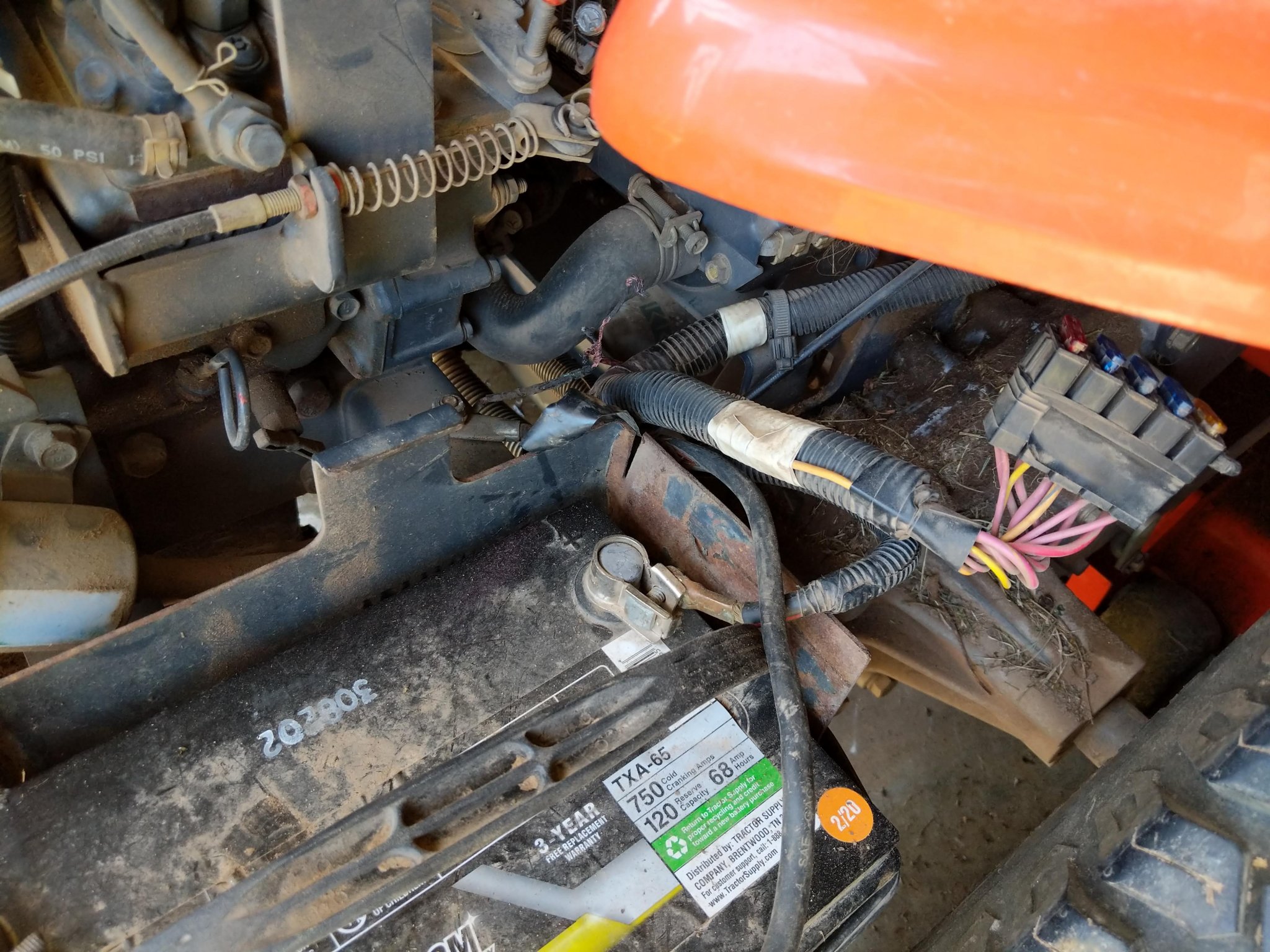

My grandpa has a Kubota ZD21 and was mowing and snagged a tree and it pulled the battery from the tray and now it won't start. I found this ground wire that seems to be the issue, when reconnected I can get the mower to try and start, but this wire starts burning. I know I need to replace this whole wire, just wondering if anyone can help me figure out where it leads. I suspect the starter. It doesn't start to smoke until you engage the starter. When the key is in the On Position, and in the Energize Glow Plug position it doesn't smoke, only when you turn the the Start Position. Any help is appreciated.

The original battery fit in that tray and had a cover. The negative battery terminal is where your picture shows the positive terminal of a wider and shorter battery. The negative cable grounds to the frame right behind the battery tray. The positive crosses under the engine and goes direct to the starter. You either need to get the correct battery for that so the cover fits on it or figure a way to tie that battery down.
The original is an odd size. Probably why its the way it is.
5,341
1,403
Not sure what wire you are describing.
From the battery positive terminal the large battery cable does go directly to the starter solenoid.
If that is smoking then it will need to be replaced.
But you say that you are concerned with the ground wire. The battery ground wire normally goes from the battery negative post to a ground point on the frame or the engine. That point could be a bolt on the starter but that would be unusual to me and not standard factory wiring.
Please describe what wire is smoking if it is NOT the large positive battery cable (that may not be red in color)

I have marked up one of the original photos. Does my RED box surround the burned wires?
You need to open up the corrugated plastic covers where I marked with yellow lines so that wire colors can be seen.

I had the same melted wires, the all appear to be grounds. I spliced in new wires, replaced the combi box ad the starting switch. Jumped out all of the safety switches and it still wont start. i am only getting 9.6 volts out of the ingnition switch, and the same at the starter relay. I have the whole wiring harness opened up and don't see any burned or cut wires. It will start once in a while like every 5-10 times i turn the key... If anyone has any suggestions i would be grateful.

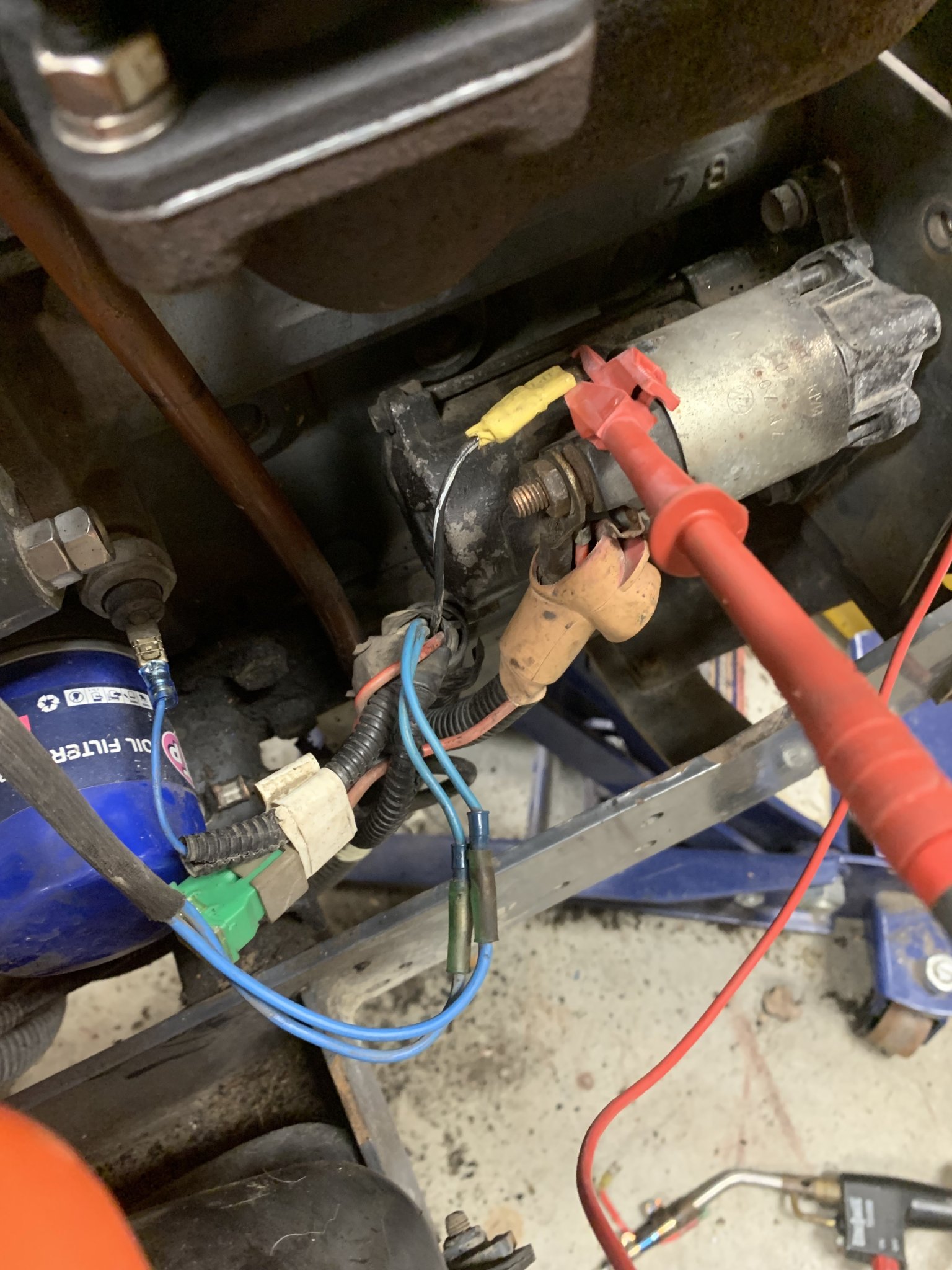

absolutely right. There is a ground on the other side from the frame to a piece of square tube bolted to the engine. See attached. Cleaned both sides and put it back together no change.

ok so starter mount bolt to negative battery post = .051VDC.
The issue is the trigger terminal is only getting 7.5 volts now. See attached. Where do I go next?
