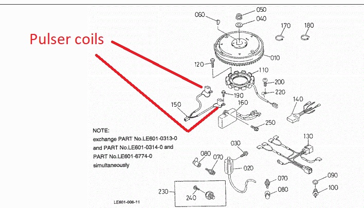

You need to fully understand the spark ignition operation on your engine.
Yes there are coils to produce sparks for the plugs but something has to provide a signal to the coils telling them when in the engine's rotation cycle should they fire the plugs. In old gas engines there would be a set of points inside the distributor sending a signal to the coil.
In your engine, there are pulser coils located very close to the flywheel. there is a magnet embedded in the flywheel and as the magnet passes each pulser coil a current signal is generated which then tells the control box to fire the coils. To check the pulsers you do not have to find them just the 4 pole electrical connector between the pulsers and the control box.
It seems likely since you lost first one plug's spark and now both plugs spark something is disconnected in the wiring or a wire is in the wrong place.
