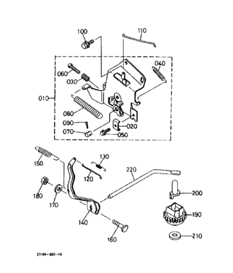

Hello all, I had some issues with an aftermarket carb that I put on, combined with dirt in the fuel tank, so I figured hey, why not replace the line, filter, pump, and get it all good as new! I took upon myself to do just that, and now after putting it all back together, the good news is she runs. The bad news is, I have two problems. I think the govenor/throttle setup is off somehow, there is a spring that dropped and I'm not sure where it goes, but even when I push the throttle the whole way up, it just idles. It's moving the throttle/choke assembly in the front, but the back part, that actually controls the butterfly that regulates the air/fuel going to the machine, and is hooked to the governor doesn't seem to pull over.
The second issue is it's shooting gas, it seems out of the top of the carb, I'm hoping that's just a stuck float, I'll look at that later. So, I was hoping one of you kind gents has this model and might actually have a photo of your throttle and governor setup so I could see where the big spring that dropped out of mine goes :)
