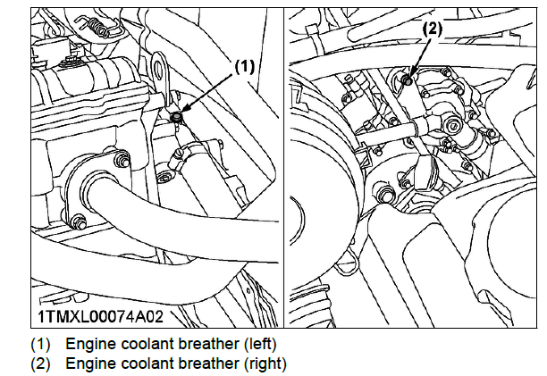

The RTV-XG850 or Side Kick cooling system has 2 bleeders that must be bled if the system gets very low and is refilled. If they are not bled, the coolant can not circulate and the engine will overheat.
Thank you so much. I bet this is the issue I'm having. Can you tell me where the bleeders are located and how to go about doing this?

There is a bleeder on the thermostat housing and one on the back of the cylinder head, Fill the radiator with coolant, loosen the bleeder a couple of turns, until there is straight coolant leaking. Bleed each one then top off coolant. Screenshot (17).png

There is a bleeder on the thermostat housing and one on the back of the cylinder head, Fill the radiator with coolant, loosen the bleeder a couple of turns, until there is straight coolant leaking. Bleed each one then top off coolant. View attachment 145260
That fixed my problem! I really appreciate the help and advice.
