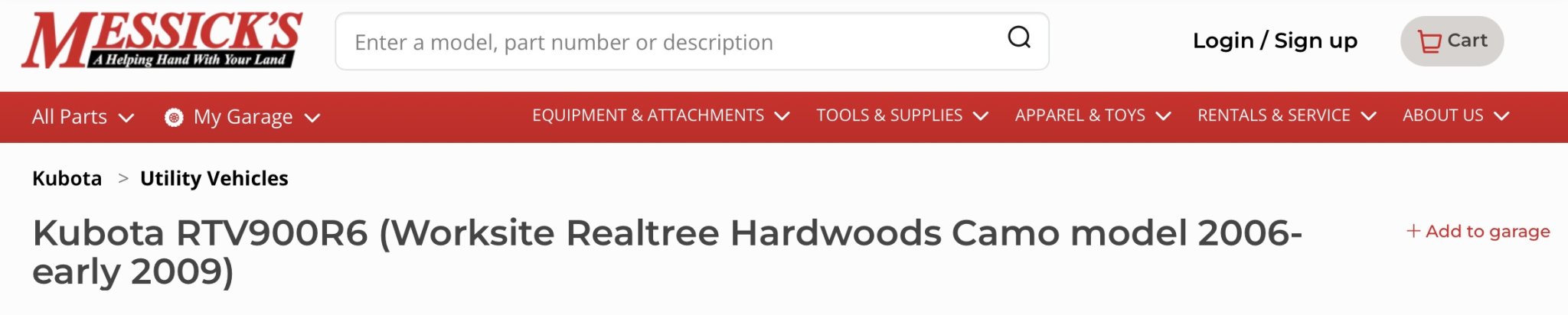

Thanks for the reply Dan.
Mine is camo if that makes a difference.
# KRTV900A61066376
Should be a 2006
Thanks again

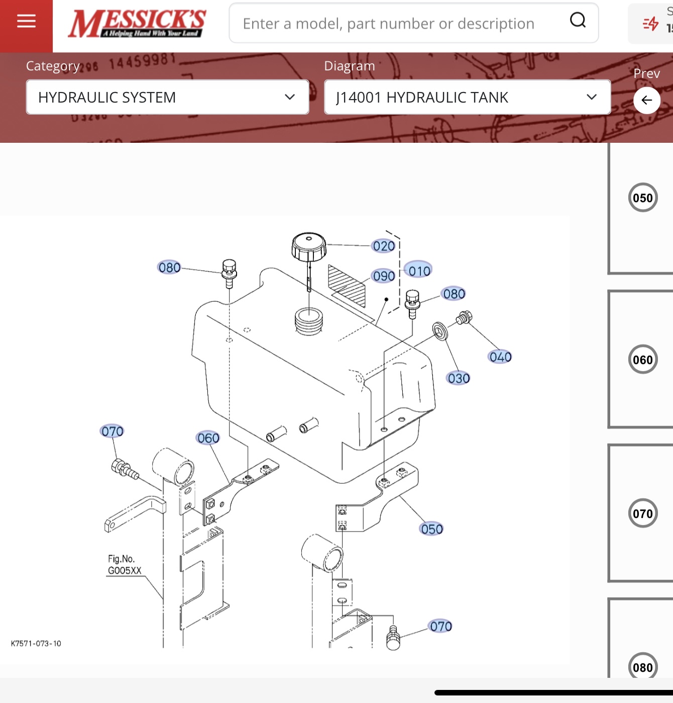

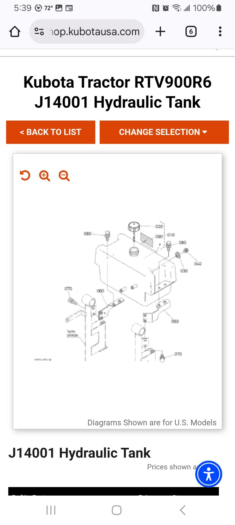

Looking at this model’s parts list there is a tank..
The diagram is not very helpful in locating it but here it is

Unless it has some home-made cobbled system, it has a reservoir.
It should have a plastic tank mounted between the frame rails at the very rear of the unit.
whitetiger
Nov 20, 2011
3,137
1,561
Kansas City, KS
The tank is under the bed, between the frame rails at the rear of the unit.
The #2 reference in the circle is the fill/check cap on top of the tank.
