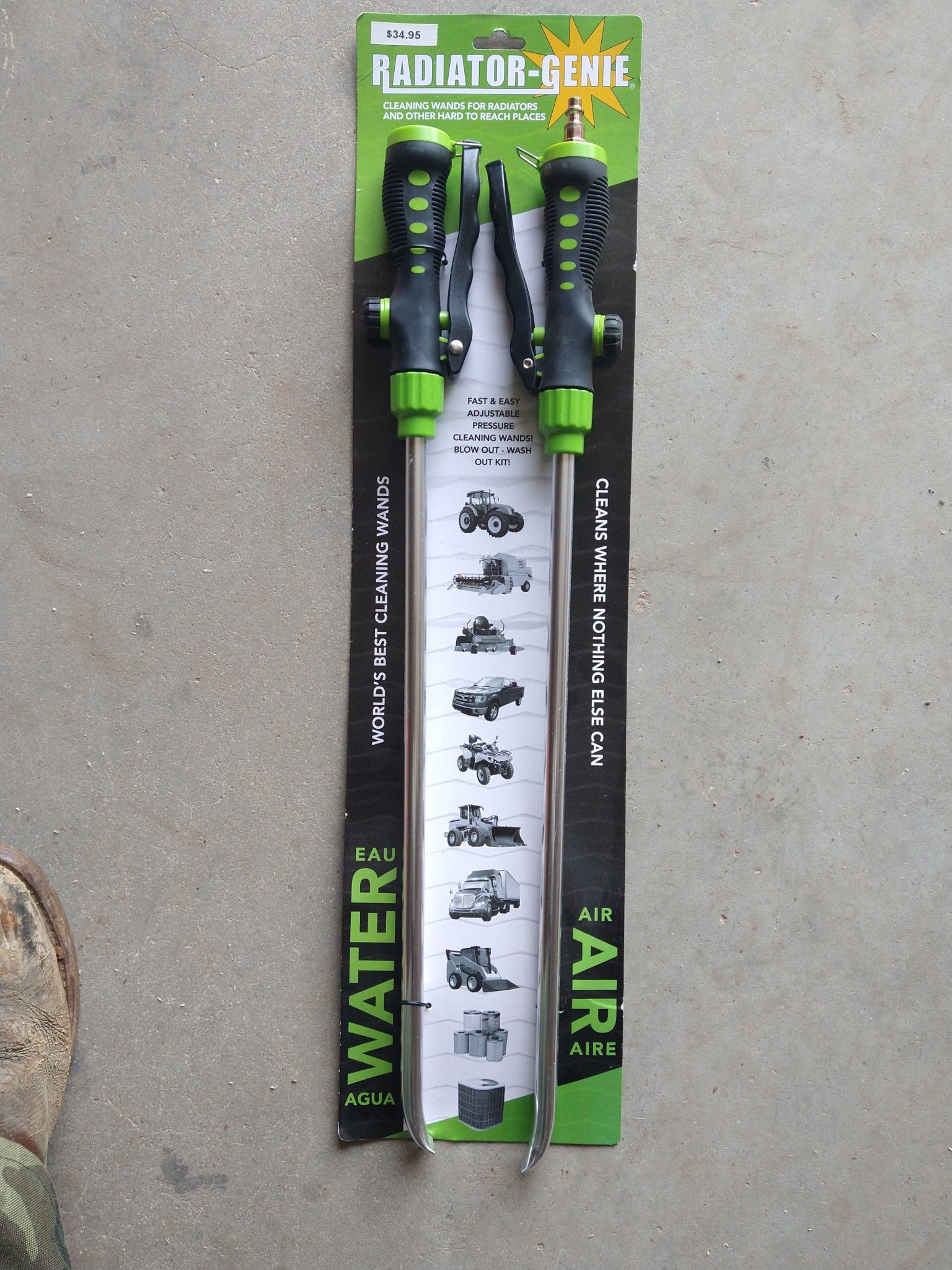

A lot depends on what is being mowed or worked. I use the radiator genie and it helps.

Replace the pre-screen, get a radiator genie air as suggested above for routine cleaning, and use coil cleaner and the radiator genie water once a year or more often if needed for a more thorough clean.
