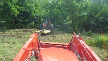

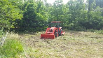

Like yourself I'm new to this, but besides the forum I'm lucky to have a dad who grew up on the farm. We have been working on getting the property back in shape, 60 acres is shared cropped out and 20 acres are woods/buildings.
I purchased the L3560. So far, it has accomplished everything I needed it to do. I can tell you my dad on his MF 275 can pull through the brush faster than me, but I can still get through the brush.
Now that we have some of the areas open up, the mowing of these areas are quick with the L3560 and 72" rotary mower. The current area we are working on is about 5-6 acres.
I have been able to push over some of the smaller trees that were in our way. Most likely, this fall we will have the neighbor come down and remove a few trees for us with his bulldozer. The trees could be dug out, but it is just easier, quicker, and safer to have him come push them over with his dozer when we are ready.
I purchased my tractor with the loader, rotary mower, and the QH. This is going to keep me busy for a long time. The loader I can push trees out of the way and load up cut up sections and move them. I would eventually like to add three things to the tractor. A third function valve so I could purchase/use a grapple. I would also like to get a box blade to work on some of the paths we are making.
