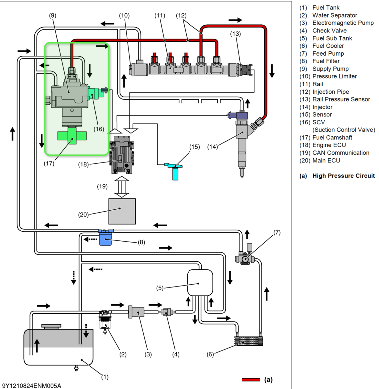

The schematic of the CR injection system with all the components is far more complex than mine with a lift pump, filter(s), injection pump and injectors. Like said, complexity breeds failure especially with lowest bidder components.
