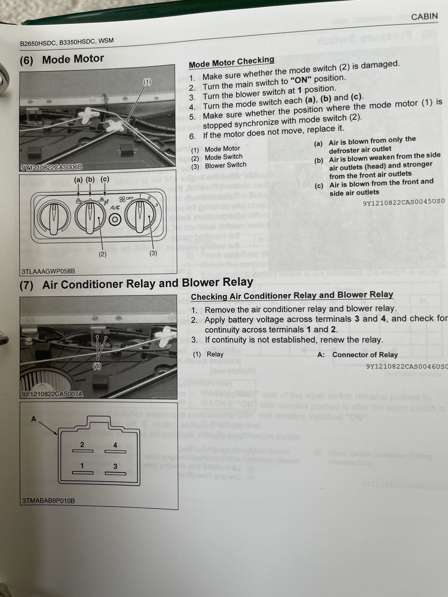

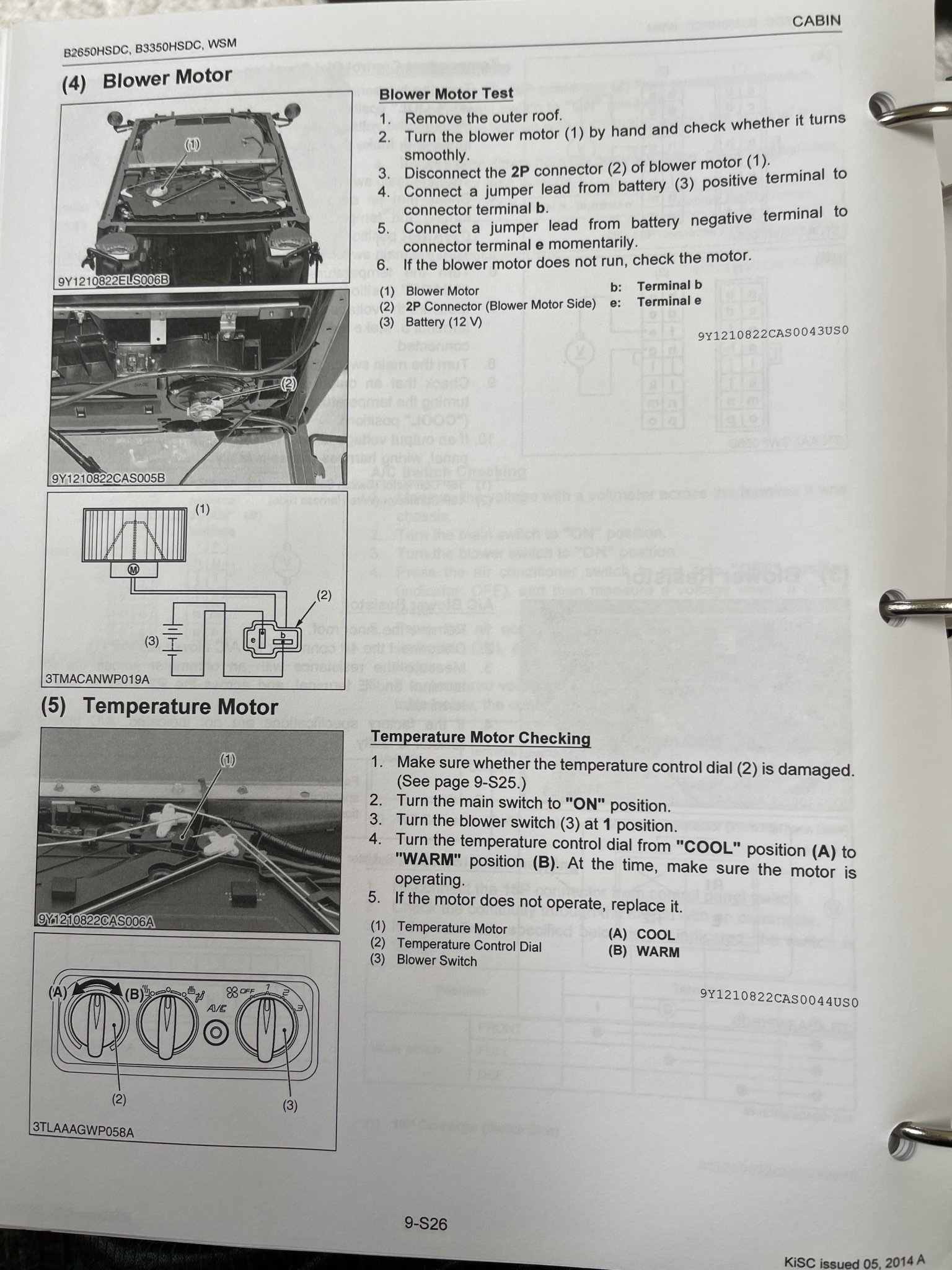

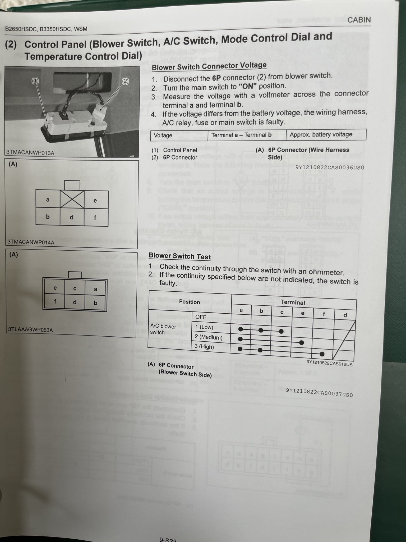

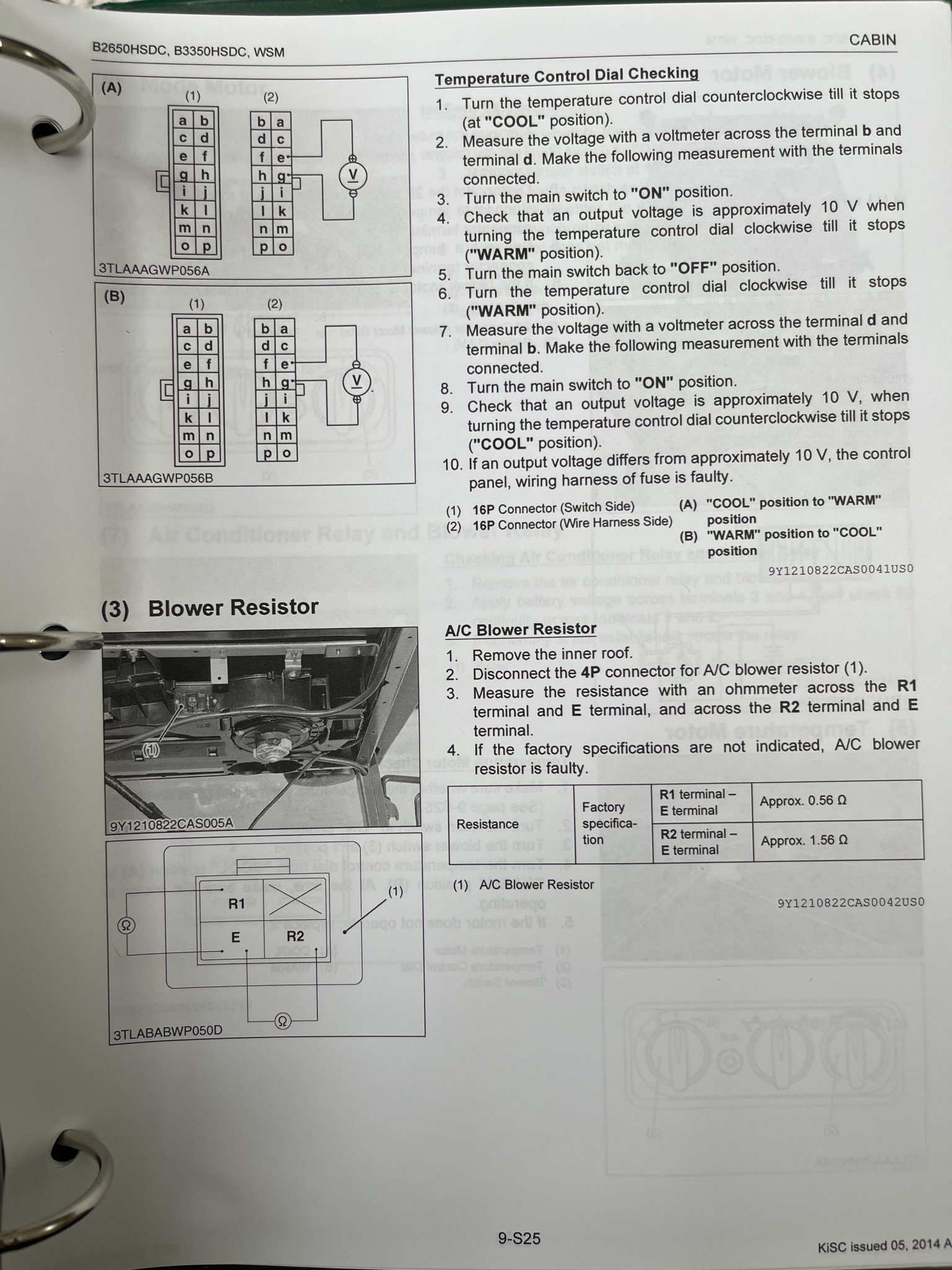

These are from my B2650 WSM which is identical to the LX2610 WSM. Maybe Kubota uses the same thing on yours.
Thanks, but it’s a M5700 and it is totally different. I have a shop manual. I wish I could find the switch diagram but I can’t find it in the shop manual. Thank you for the info. I wish it was useful in my situation.

Both of my manuals have it in the Cabin section under Servicing, chapter 6. Weird spot to place electrical content.
