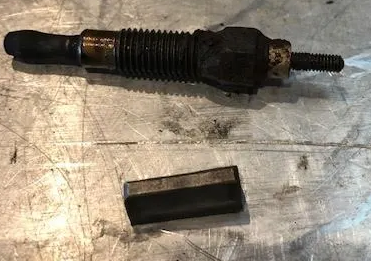

I recently picked up a M4500DT. The 3-pt lift arms do not go up. The auxiliary hydraulics have pressure though so I suspect the hydraulic pump works. When I dropped the hydraulic filter, I did find this piece looking like a gear tooth in the bottom (see attached). I put a glow plug in the pictures for scale.
I worked on a Ford 8N recently with same lift arm issue. Those have a common problem that the lift cylinder gets sticky if not used for a while. The fix for this on the Ford is simple- just open inspection plate and reach inside with a long pry bar. Is there a common issue with this M4500DT like this or do you suspect it's a broken linkage or gear inside causing the issue? I do not hear the relief valve when I move the control level to UP position.

I agree it looks like a broken gear tooth. It might not be the only one the one in the picture happened to make it to the filter, another one could jamming the lift arm. I wouldn't keep trying to operate the lift so as not to cause anymore problems. before pulling did you drain the oil, was there any metal flakes, pieces, etc.? View the parts breakdown and try to determine the broken part. I could be wrong but if the filter is on the discharge side of the pump it's possible that the tooth came from the pump itself and you may have two problems. Good luck
