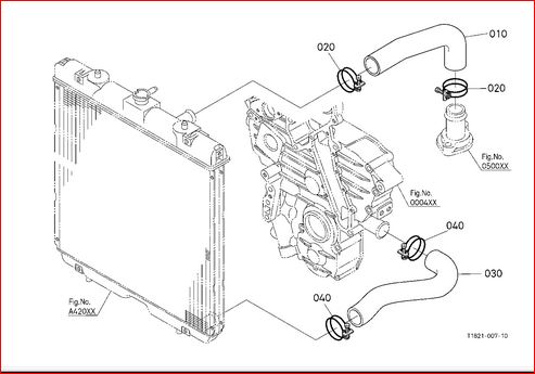

I read online to drain the radiator go to the right side and loosen clamp and pull hose. I did this and drained what looked like hydraulic fluid or something.
Can some look at the picture and tell me what I drained and where to add it back in the tractor.

It's hydraulic fluid, you pulled a line to the hydraulic fluid cooler.
Try moving back and remove the larger water hoses.
