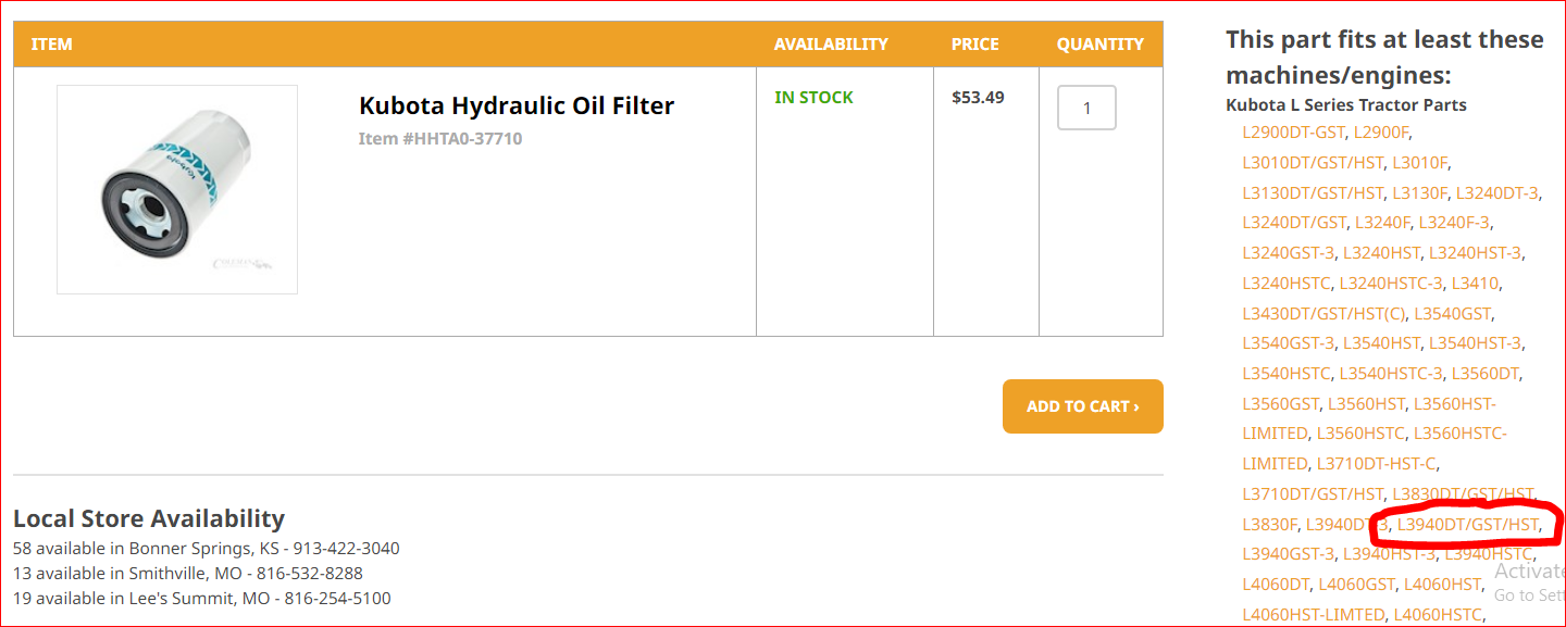

HHTA0-37710 is the filter I come up with for that model.

HHTA0-37710 is the hydraulic suction filter which is on the Right-Hand side of the tractor, and HHTA059900 is the HST High-Pressure filter which is on the Left-Hand side of the tractor.
If a WIX 557616 screws on then the HHTA059900 should screw on as they are the same thread.

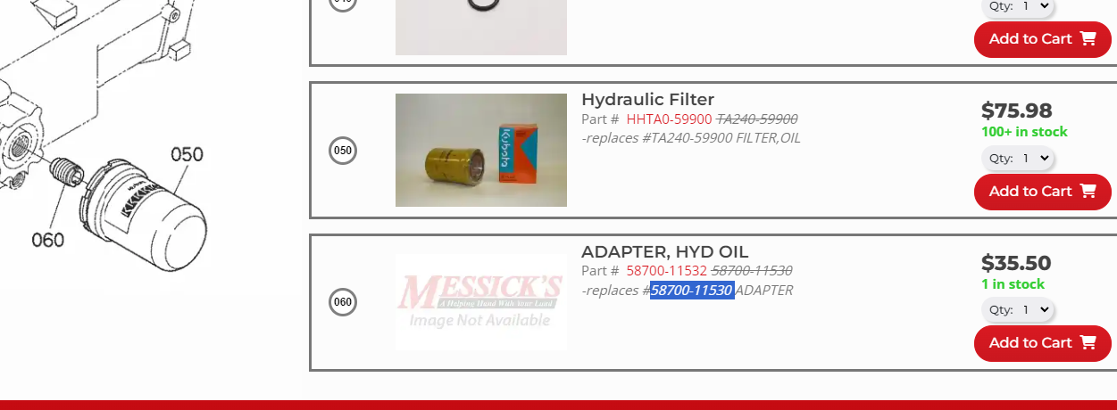

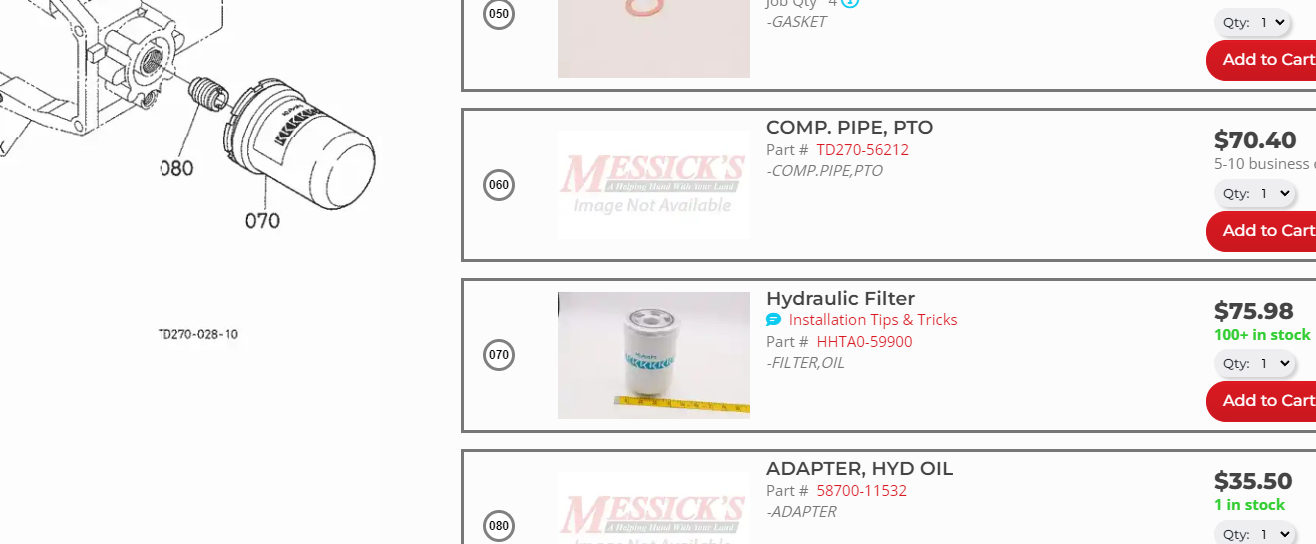

I recall there was an update to that threaded adapter due to filter update. The early 2007-09 had 58700-11530, the revised part is #58700-11530.
30,770
6,824
I've also seen the wix filters with and adapter on them and it gets stuck to the tractor.
Look on the tractor and see if there is a slotted ring on the tractor.
