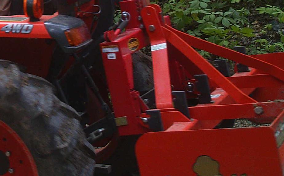

mdhughes
L3901DT
Dec 10, 2014
1,230
663
Ste Geneveive county, MO
I have mine in the top holes, this makes it possible to get the right angles for using the box blade, but keeps the top of the quick hitch from hitting the fender lights. In the picture below I have the top link set for the box blade to be level when down, when I shorten the top link to make the blade dig, it does get very close to the lights. So far I haven't had any troubles, but I try to check it each time I change the top link length.
