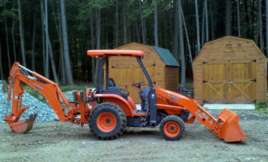

Hi All,
New here, found the site via a google search. We have a Kubota L39 we use for some small food plots and property maintenance on our place in Upstate NY.
The L39 has ran perfect until the other day. I drove it for about 2 min to a spot where I keep the backhoe, I took off the disc we had on there, then backed up to attach the backhoe. All of a sudden I could not get the L39 to start again, the engine turns over but its not starting. There is some blackish smoke that comes out when trying to start.
I checked the battery it was fine, charged it anyways. Tried to start it again, no luck. There was 3/4 tank of fuel in there, so that shouldnt be the issue.
When searching around this site there were a few mention of bad sensors in the seat or pto, but if it was a bad sensor it wouldnt turn over at all correct?
Any idea's? All help is appreciated.
