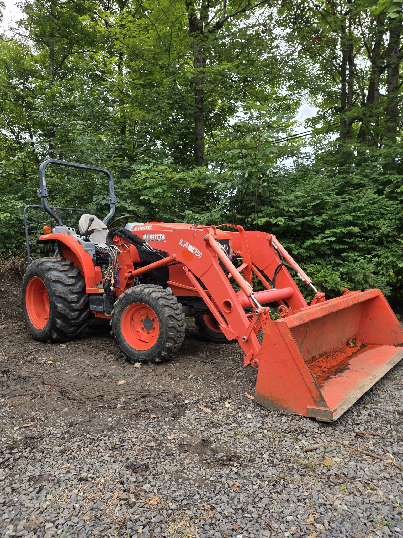

My Kubuta L3560 Hydrostatic lacks pushing power when trying to fill the bucket. When I hit the dirt pile I get a ton of whine and the engine doesn't bog down at all, in fact, the RPM increases slightly, as you may notice in the video. Stall guard is OFF. Seems to be better after running the tractor for 30 minutes or so. I'm not sure how to share a video on this forum, so I uploaded it to YouTube: https://youtube.com/shorts/yc9bxEc_rTw
Similarly, the top speed should be ~16mph according to the manual but I only achieve 10 on flat ground
Engine runs well, the bucket seems to function perfectly and the 3-pt works perfectly as well. I did notice a bit of a buzzing sound, which you can hear in the beginning of the video.
What could cause this? Is my hydrostatic pump/motor bad? Could it be a charge pump issue? Are my relief valves malfunctioning?

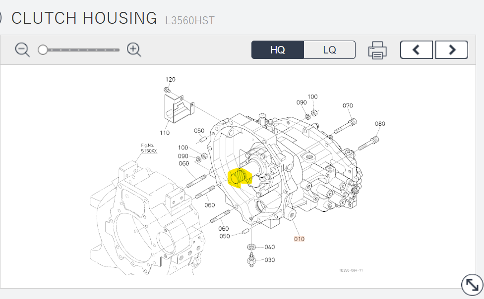

Sound to me like you have stripped splines on the hub or the input shaft on the HST.
Further test would need to be performed to be sure of that.

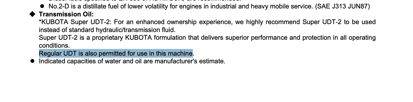

Well here my 2 cents
#1 I think it's a big mistake to use aftermarket filters and fluids for the HST, which you did.
#2 Is does not say that the fluid is SUDT2 compatible or comparable.
It says UDT and UDT2 (10 years obsolete fluid), and those are much different than SUDT2.
Now, is this issue or not I can't tell you, but it has been know for both incompatible fluid and incompatible filters to cause the exact issues that you're experiencing.

If it was the splines, wouldn't it just not go at all, rather than being down power? I mean, I can imagine a friction fit still working, but if the splines are damaged enough for it to spin, then surely it'd just spin under any load at all?

Fair point. Perhaps I will try Kubota Super UDT2 in this machine. The manual does state that regular UDT is also permitted in this machine, but who knows, maybe that could play a role in the performance and issues I am having. Thanks for the suggestion

Brand of transmission oil is not going to change that behavior
