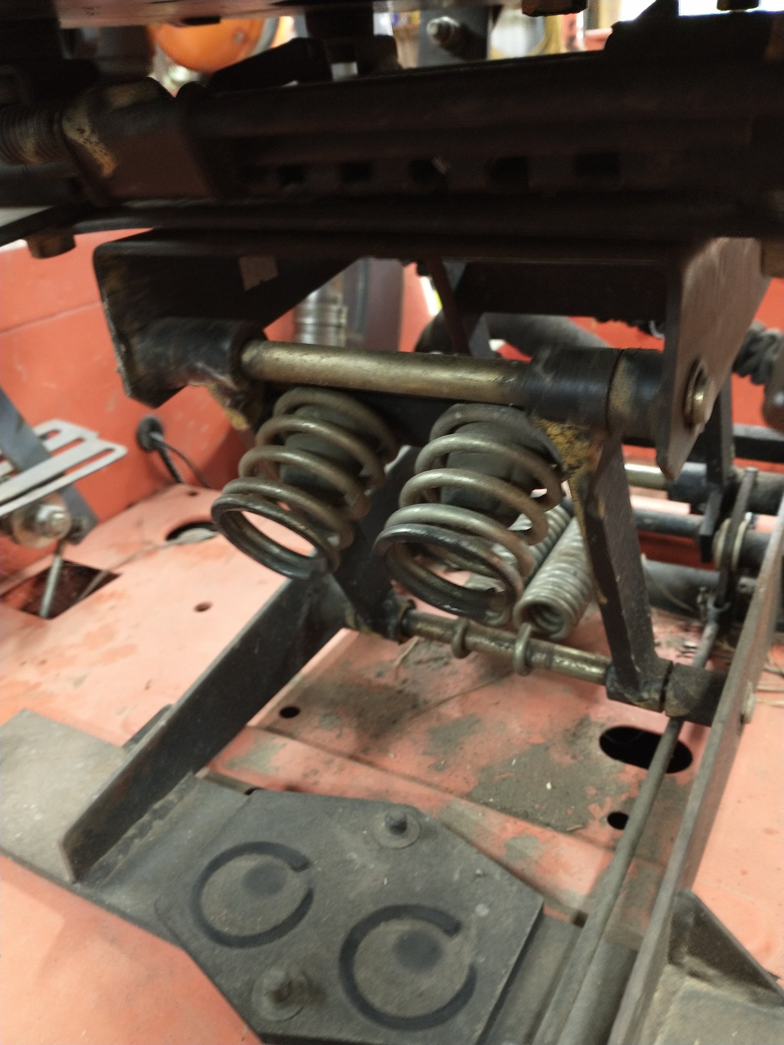

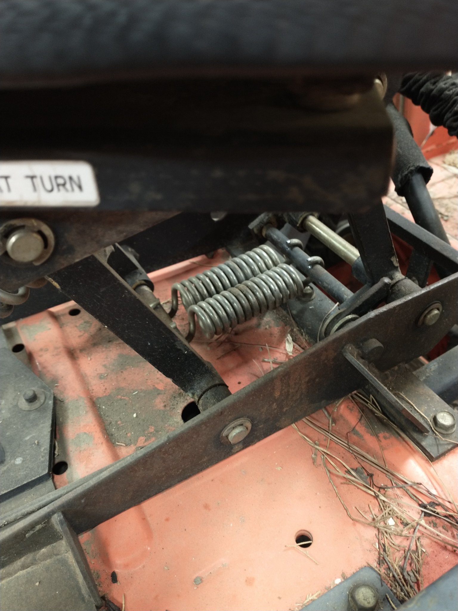

Can you post a picture and point out where the spring goes? I had to do some work on my seat, but I just remember two compression springs. It may be a while before I'm at my tractor, but I'll see what I can do.

Assuming we're talking about #150 in the parts list posted above. I measured 0.194" wire (may be 5 mm), 1.12" diameter O.D., and I count 13 turns. I can't vouch that they're OEM because I bought the tractor used, but they work fine.

Since I measured these I'll post their dimensions too. Item #300, 0.194" wire, 1.82" O.D., 5 turns, forgot to measure the length.
