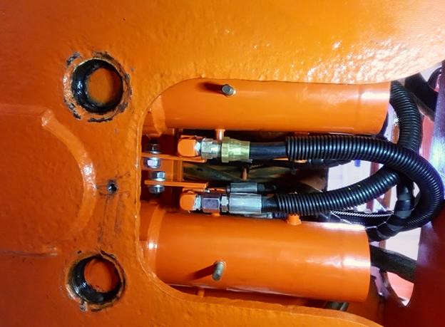

Here is the bottom of the BT900 showing the open cylinder bushings.

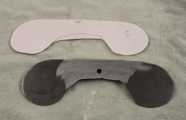

Here is the template and the metal cutout cover.
Note the brace welded on to keep the cover from turning.
