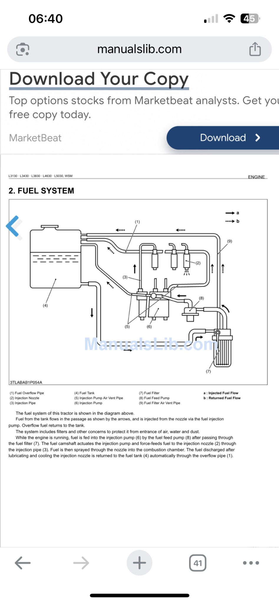

Kubota L3400. I changed oil, oil filter, all air filters, and fuel filter less than 20 hours ago. All OEM parts for my specific model. Recently very hot in Indiana 90+ degrees days. Tractor runs great for 15- 20 minutes and then acts like it is starving for fuel with sluggish to no response on the gas pedal. If Inlet it sit for a few hours, it is fine for 15-20 minutes , and then same thing. I think I have a vapor lock with fuel getting too hot somewhere causing the issue. I have tried taking off the fuel cap to see if it would release pressure. Did not work. Looking online having trouble finding maybe if there is a clogged fuel vent ? Also engine temp is running normal and not overheating. Air filters very clean. I have a attached a fuel system diagram online I found. I am going to try and find the vent pipe on there today. Any help or advice appreciated

So welcome to the forum... normally, these threads turn out to be junk in the fuel tank or algae in the tank. Something floats around the tank until it get sucked into the outlet pipe. You can check a couple other things, like crack the fuel cap to make sure the vent is not plugged up (has happened, cause a vapor lock of sorts).

I had a similar issue this is going to sound a little bizarre but the next time you feel like the tractor is vapor locking loosen the fuel cap if the engine starts to run normally again the vent in the cap may be blocked that was the issue I experienced good luck
