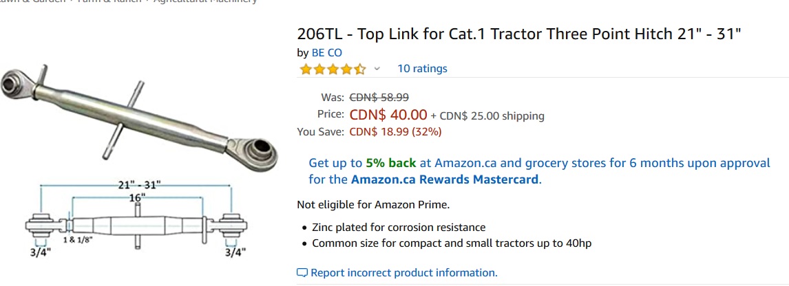

Your tractor has Cat 1 3 pt hitch so that sets a generally followed standard.
This info should be able to guide your selection.
The center to center dimension for the end holes varies between 21" and 31"

Thanks Dave, I have ordered a 520mm-740 MM hoping it should give me enough to tip. Much appreciated.
