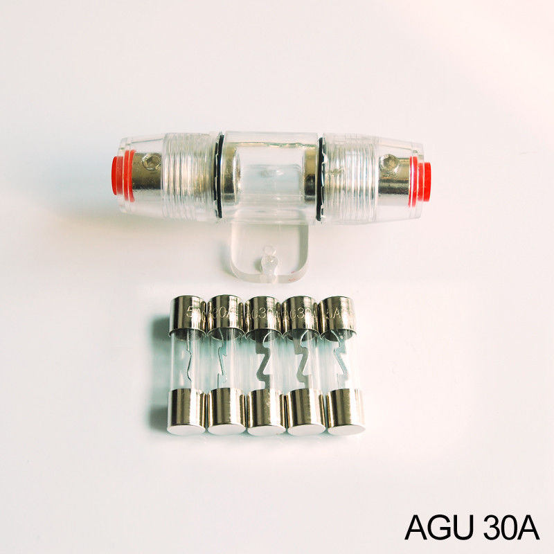

Just getting back to this thread. The "homemade fusible link" Dave highlighted
was originally an S-shaped exposed metal fuse. On my L345, the terminals got rusty and failed.
I replaced it with a 30A in-line fuse like this. Works fine.
Nice to hear my guess was reasonable. :)
There is still the issue of why the current draw for the GP's is high enough to smoke the insulation on the homemade fuse/link.
Dave
