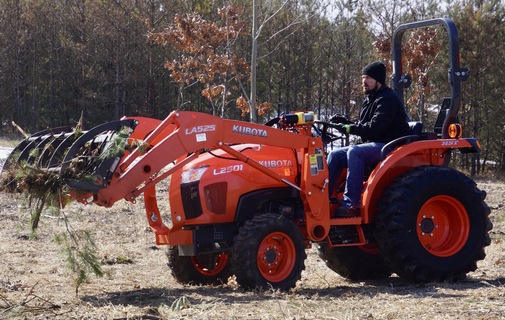

Including a picture of my son driving my L2501 HST for reference.
You can see the loader has the LA525 designation while the tractor on the hood has L2501. The back fender has the HST designation sticker.
