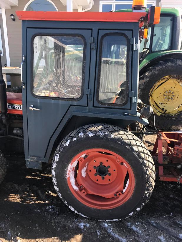

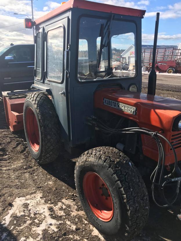

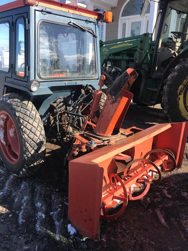

Here is a small preview of my little orange beast.

You have a great machine in the L245.
In the Asian market, it is a medium size machine.
As a medium sized machine, it may well have the live pto.
Your blower, with hydraulic chute rotation and deflector, + tractor cab are quality stuff which will serve you for decades if looked after. Try and stay off of public roads where salt or calcium is used to melt ice. That stuff will take years off the life of a machine.
Does the cab have a heater? Later: Now I see the hoses going up to the roof of the cab.........
Depending upon the area where you live, the turf tires may or may not work well. Certainly chains (rear only) are an option. Another is screw in tire studs. You run them in with a cordless drill.
http://www.gripstuds.com/
Remember you only have brakes on the rear wheels so on slopes you might not have the braking you expect. However, in 4 WD the drive train takes some of the rear brake and sends it to the front wheels.
