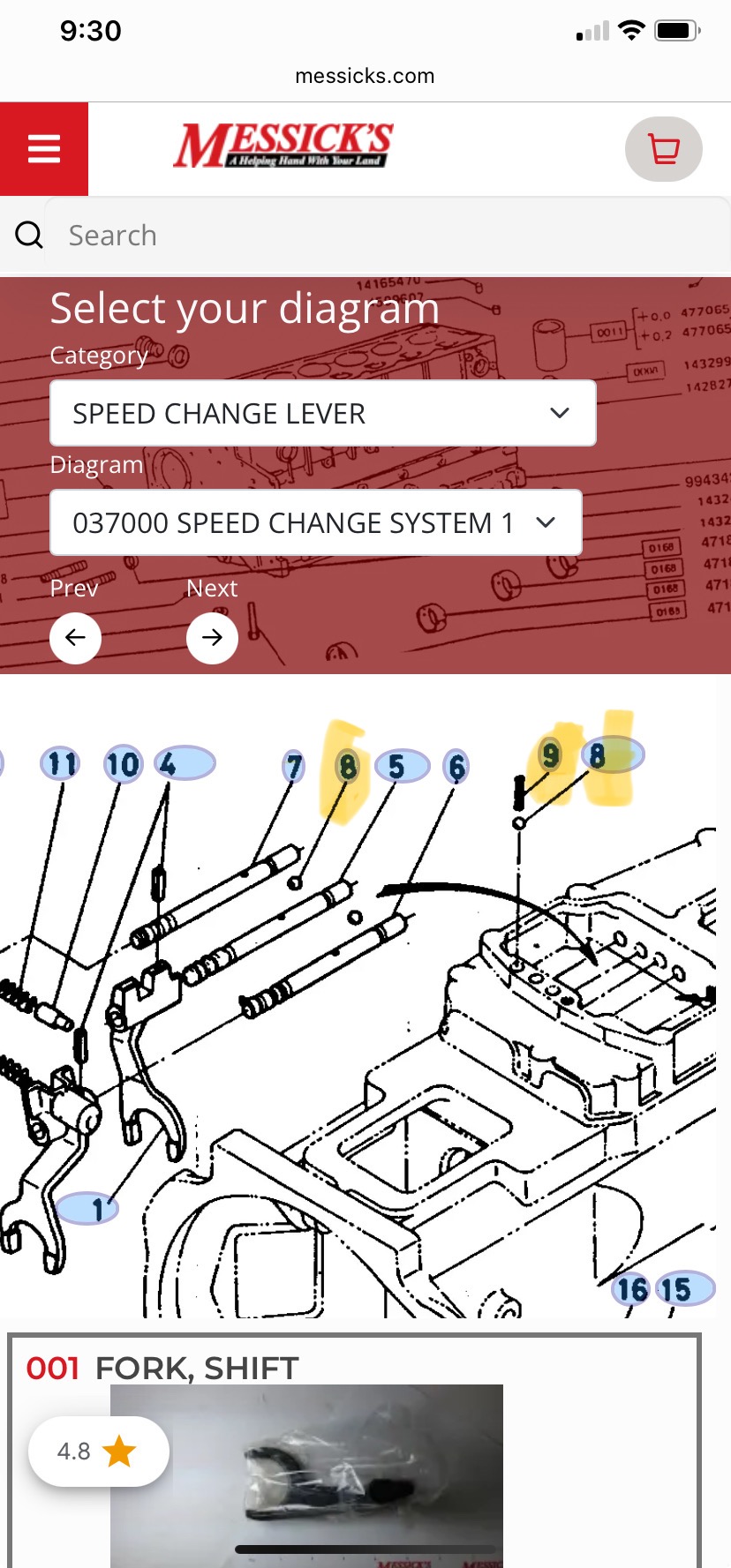

Next time you take the cover off check that you didn’t lose any of the balls #8 or the springs #9, they are what keep the fork rods in place so only one at a time should move. If the balls are corroded they may not move between the rods like they’re supposed to.
