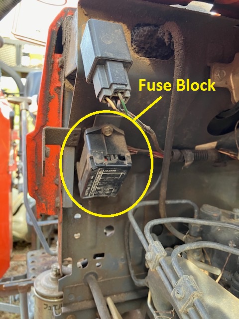

F Farmer62 New member Equipment Kubota Nov 28, 2024 1 0 1 New Hampshire Today at 11:41 AM #1 I just purchased an older L2250 I think it is a 1987 with 686 hours. I am looking to fin out where the fuse panel is. Thanks in advance.

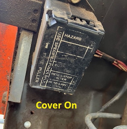

Flintknapper Well-known member Premium Member Equipment L2350DT May 3, 2022 1,768 2,226 113 Deep East Texas Today at 12:46 PM #3 Probably the same as my L2350. Remove the right side engine panel (same side as brake pedals). Look on the upper part of the firewall . There will be a small fuse box there (may or may not still have a cover).

North Idaho Wolfman Moderator Staff member Lifetime Member Equipment L3450DT-GST, Woods FEL, B7100 HSD, FEL, 60" SB, 743 Bobcat with V2203, and more Jun 9, 2013 30,233 6,396 113 Sandpoint, ID Today at 1:24 PM #4 Right side under hood above battery. Reactions: 1 user
