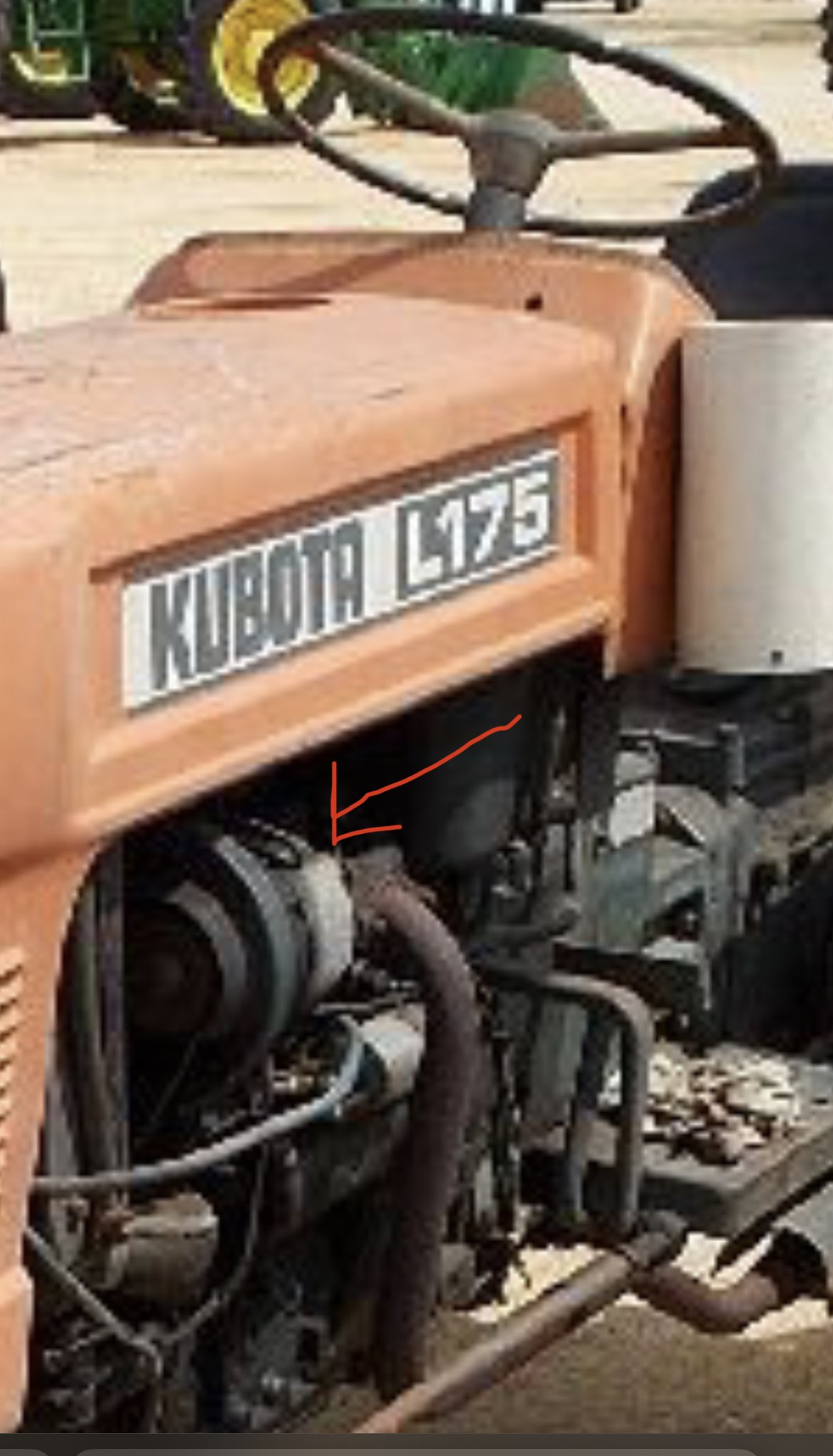

Welcome to the forum! I’m not familiar with that tractor but never heard of having to pull a crank pulley to remove and replace a belt. Normally I just loosen this alternator bolt on the guide and take the tension off the belt. Then take it off all the pulleys, and fish it around the radiator fan. Same to reinstall. Fish around the radiator fan, route it back on all the pulleys, then tension the belt by moving the alternator out and tighten that bolt.
take a pic of how it is routed before you remove it.
The other answer is to find a service manual and it should have instructions.

I dont have an L175, no. Thats just a picture from the internet I used to show the slide bracket on the back of the alternator that loosens or tensions the belt. loosen that bolt, push (rotate the alternator toward the engine to take tension off the belt. Then it will come off the pulleys.
If there is no room underneath the crank pulley to get the belt out, it might be a good idea to take a pic of it with your phone and post here.
