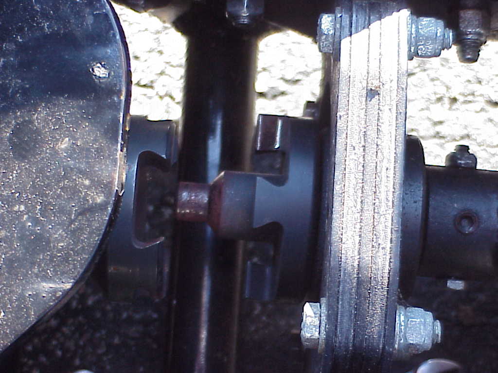

I have been giving this issue of the K Connect connection parts wearing out prematurely some thought over the past few days. I developed a hypothesis as to the cause and effect of raising the snowblower too high when it is being powered by the PTO. Today was a warm day, so I took the time to remove the 4 bolts that hold the safety cover off of the K Connect and photograph how the coupling works and what goes wrong when you lift it too high. In this first picture, you can see the way that the connector looks when it is randomly engaged by pulling the K Connect lever to the engaged position. Note how the two tabs of the coupling are touching.

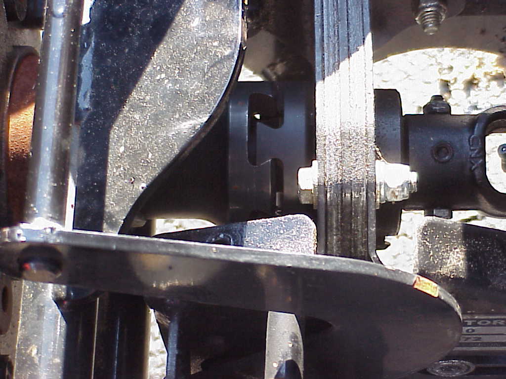

In picture #2, I engaged the coupling by starting the tractor and moving the PTO lever into the working position with the snowblower setting on the ground. You will note that the coupling isn't fully engaged, and since my locking pins for the couplings are both in the factory setting position, I believe that Kubota never intended them to fully engage tightly. I believe that might be a mistake on their part, but I will leave that to the engineers to sort out.

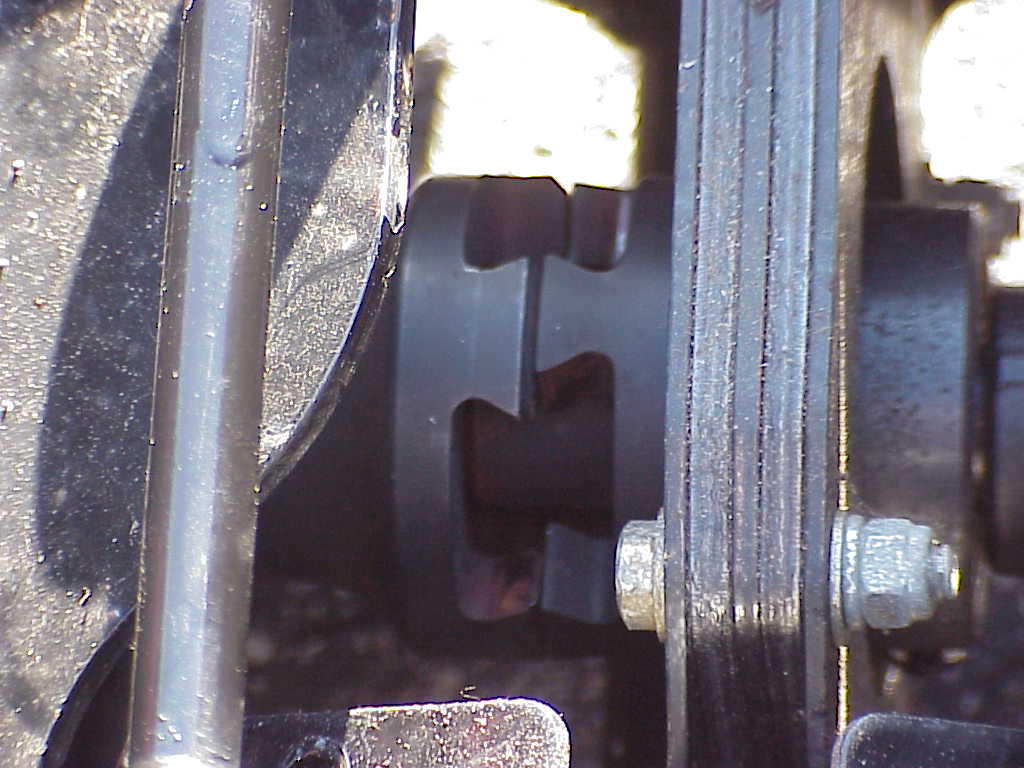

In picture #3 I disengaged the coupling to see what it looked like as I moved the bar toward the engaged position. The design of the K Connect is that the tractor side of the connection floats and only when you engage does it self-center itself.

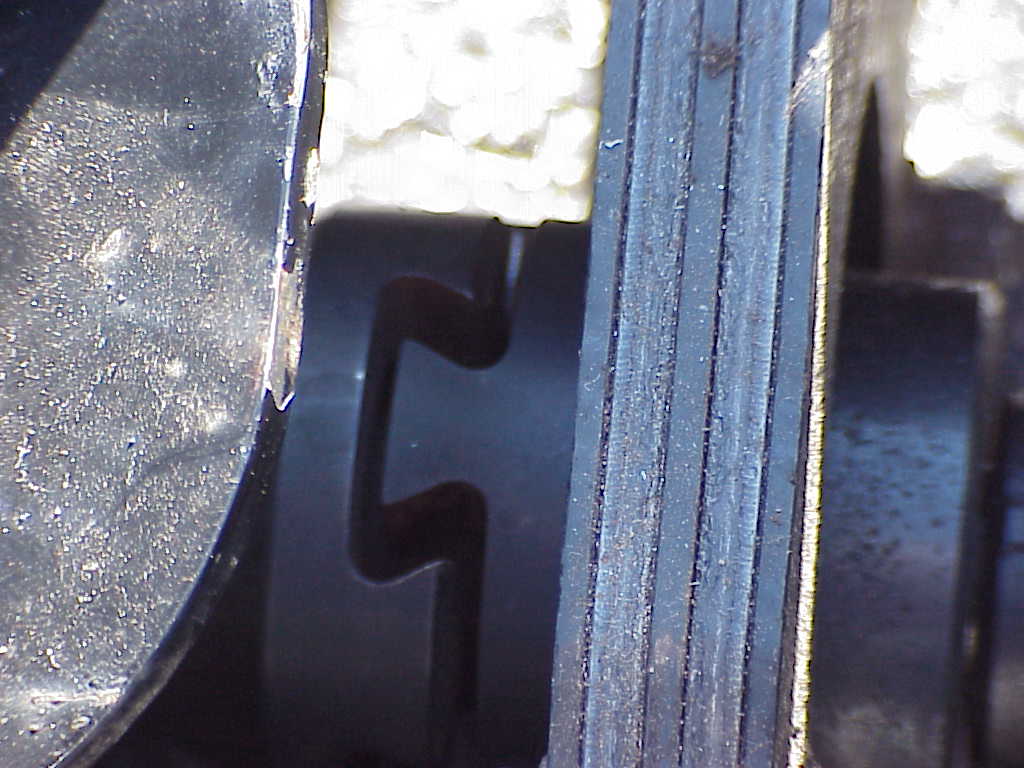

In the last picture, you can see how the coupling separates when the snowblower is in its full-up position. It doesn't look like much, but I believe that it is enough to cause the premature wears that many people are seeing.
In conclusion, I believe that you should limit the lifting of the snowblower to just an inch or so to keep it from dragging when you go in reverse. There is no reasonable reason to raise the snowblower fully, and I believe that if you don't completely raise the snowblower fully, you will lessen the wear on the K Connect coupling. As I said in the beginning, this is just a supposition of my thoughts, and I encourage you to remove the 4 bolts from the cover and perform the same testing that I have done. All pictures that I have taken were with the tractor not running since if it were running, you wouldn't be able to see the differences unless you have a strobe light to "stop the action".

Dusty, some excellent investigative work there. I am going to do the same thing you did with pics. How old are those couplings of yours? They look brand new.

Nice analysis & write-up. The only thing I would have added would be ID numbers imposed onto the pics to be sure that the order that they appear in the thread is the same as you intended with your picture reference numbers; I believe that occasionally the pictures can be displayed out of order from their loaded sequence.
When I look at pictures presented by users who are seeking answers to problems with their snowblower K-connect assemblies, it seems that one can tell which assemblies are problematic by the appearance of obvious wear visible on the teeth engagement surfaces of the 'power coupler' gears, which seem to be of a nice design manufactured with hardened material (which they obviously need to be). The appearance of wear, which seems to be evidence of 'impact' - type injury, would lead one to believe that high speed PTO engagement is to blame.
The one aspect of the system that I don't understand is what is supplying the force that keeps these two power couplers engaged when power is being delivered from the tractor to the blower. Is it a spring, and if so, would this spring system be suspected of providing a lack of sufficient force which could allow the power coupler(s) to become partially or fully disengaged? I get the necessity for the coupler(s) to have some 'movement', thus allowing trouble-free re-coupling when desired, and I wonder if this built-in 'flexibility' is a contributor to the issues experienced by owners. The suggestion of not fully raising the blower with the PTO engaged seems to be sound advice, but one would assume that the 'engineers' contemplated that users would do just that and would have designed the system to withstand such use without excessive wear and tear.
Undoubtably the entire connection system is complex and maintenance-needy. That assessment would not stop me from acquiring one; I'm still looking to add such a setup to my B2601, but with the K-connect attachment, not the previous 'spade'-type connector.
