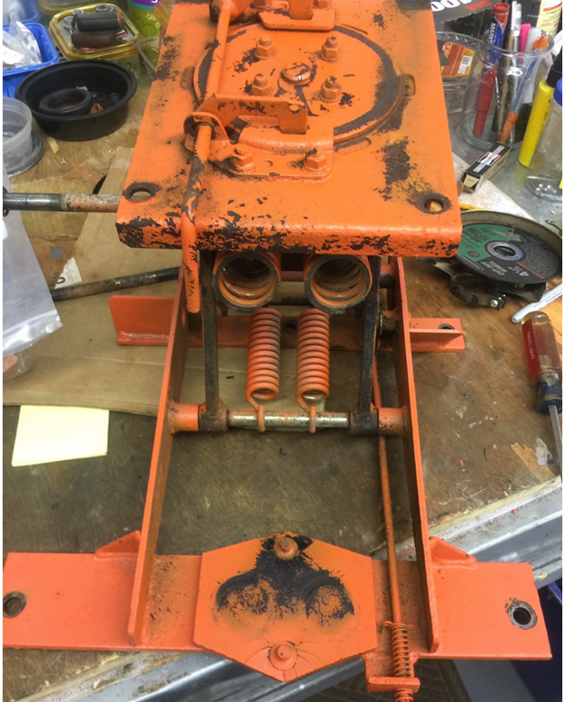

@Fischer here are some pics of my L35 while going thru restoration.
I hope this helps you.

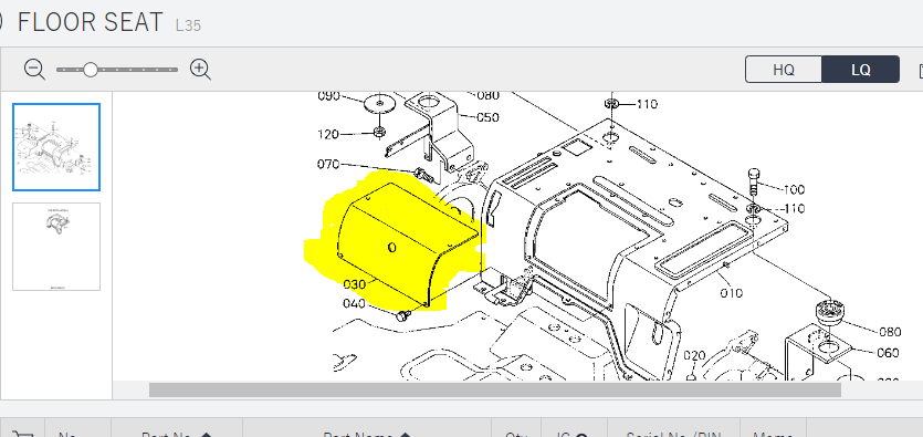

Without pulling off the seat and seat mount, and seat base, it'll be hard to see (not impossible).
You could remove just the seat and mount and front cover as Wolf suggested to start however and poke around. Seat mount is very heavy!
Removing the seat base requires disconnecting from the fenders, disconnecting the gear shift mechanism, removing the 3-Pt Hitch adjuster, hand throttle, and is just a bit more complicated.
If you've "been there" already with projects, then you can handle this! Take pictures.

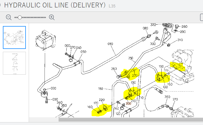

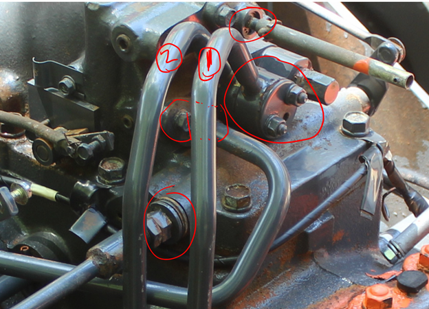

Here are potential leak points.
Pipe #1 is delivery from the front pump
Pipe #2 is delivery to FEL controls

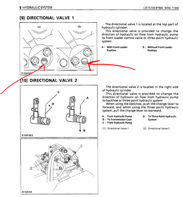

Inside the #1 and #2 round unit is a valve that decides Hyd oil flow for FEL or 3-Pt Hitch. If you take this apart - see the diagram below

CORRECTION: I misidentified the steel pipes above! Apologies.
Pipe #1 is delivery to FEL controls.
Pipe #2 in the picture above connects to another steel pipe that runs along the right side of the transmission case and up to the front pump. The joint is about where the Hyd filter is located.
Be careful if you take this joint apart. Mine was horribly rusted and I had to do some "shop engineering" to get it to work properly (hopefully your machine won't be messed up as mine was.
If you decide the leak is in the round portion where the two pipes meet, there are some support brackets that need to be removed so you can access that section. My advice is simply trace the pipes underneath the machine so you have a good idea of the layout before you start. In my situation, I'd already removed what was left of the floor and had access to everything.

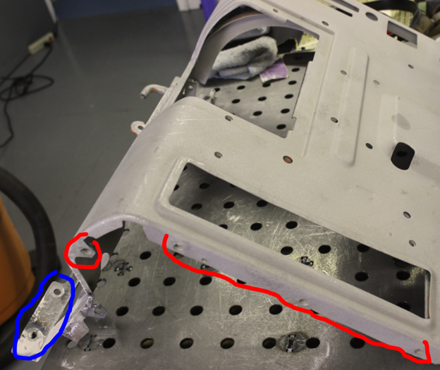

Sometimes it helps to see the real thing - here is the seat base after some work and primer.
Red are bolt holes that go into fenders and Blue are those that bolt into the floor.
The Differential Lock stays on the seat base and just needs the linkage disconnected.
