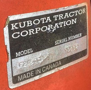

I just signed up here, but been lurking for a few yrs. Own a BX2380 and just scored a deal on a Kubota F2450CB-1 50" 2-STAGE SNOWBLOWER. Seen it on FB Market place and drove the 50 miles up and bought it.

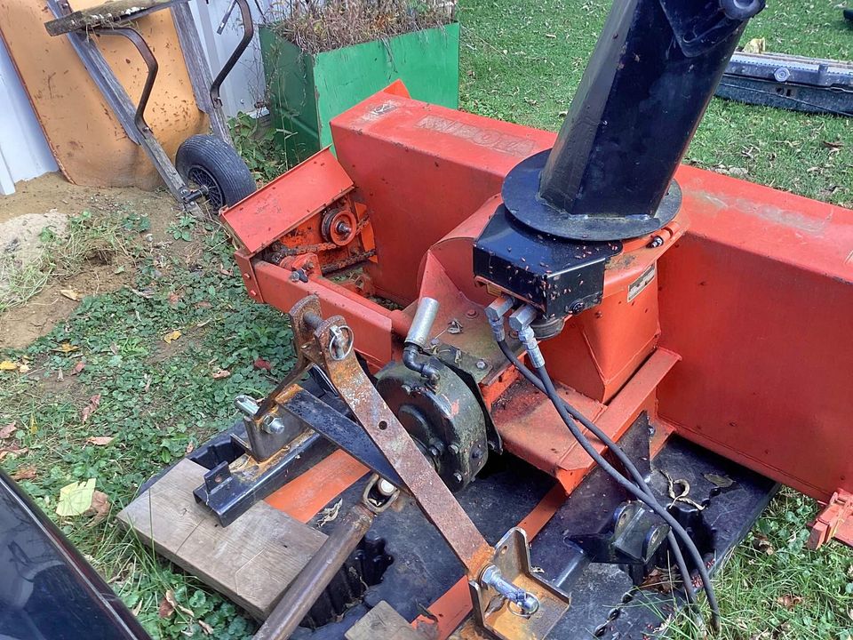

The guy who had it tried to adapt it to be a rear PTO mounted unit, see photo for his 3 pt mount. He got it mounted and made a drive shaft, fired it up and it spun backwards, lol, He said I'm done and put it up for sale cheap, said it was what he paid.
I was not going to say too much until I paid him and it was in the back of my RAM 2500. Then I told him Dude all you would of had to do was remove the gearbox on the rear and it would have tuned the right way and probably been pretty near what it needed for rpm. Dude shrugged.
No I do not want to mount it out back and spend all that time twisting my neck around and blowing snow while backing up.
How to mount/use it, thing is a BEAST of a snow blower. is it bigger than the little BX can handle? Well I'm going to give it a shot.

Some questions. When was it made and what tractor was it made to fit?
Is there a manual available anywhere? Anyone have a copy?
Is there an official mount for this thing for my BX? Don't really care as I can make one if I want.
I am thinking of mounting it on the FEL since I have the quick detach version and have already made a few implements such as a show pusher blade adapted from a Polaris Quad, it works ok, it pushes snow around.
I was first thinking of putting the snow blower on the FEL then running a 2 section drive line up to it. Would dip pretty low to clear the front axle but might work.
