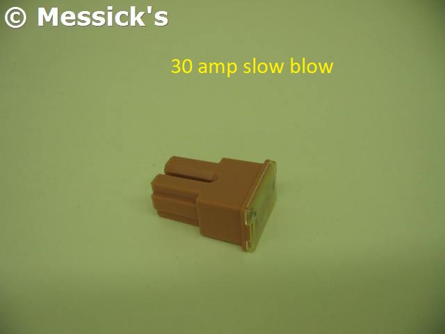

There are two 30 amp fuses but they will look totally different.
The main fuse is a SLOW BLOW type.
The other 30 amp fuse is a traditional automotive style and it powers the engine stop solenoid.
The slow blow fuse will be located near the starter solenoid.
Remove the slow blow fuse and check it for continuity,
Check the fuse socket for 12 volts on one side.
