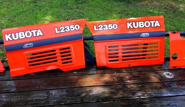

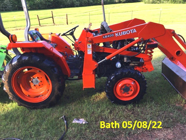

One more time for the record....
Rustoleum Kubota Orange is Orange II
Magic Kubota Orange is Orange I.
Kubota OEM Orange I and II fade to Mary Kay pink in the sun after a while.
IDK, mine is 27 years old and has seen a fair amount of sun. Hasn't faded too badly considering its age.
Factory Paint:
Just gave it a bath....so its clean, but that's all.
