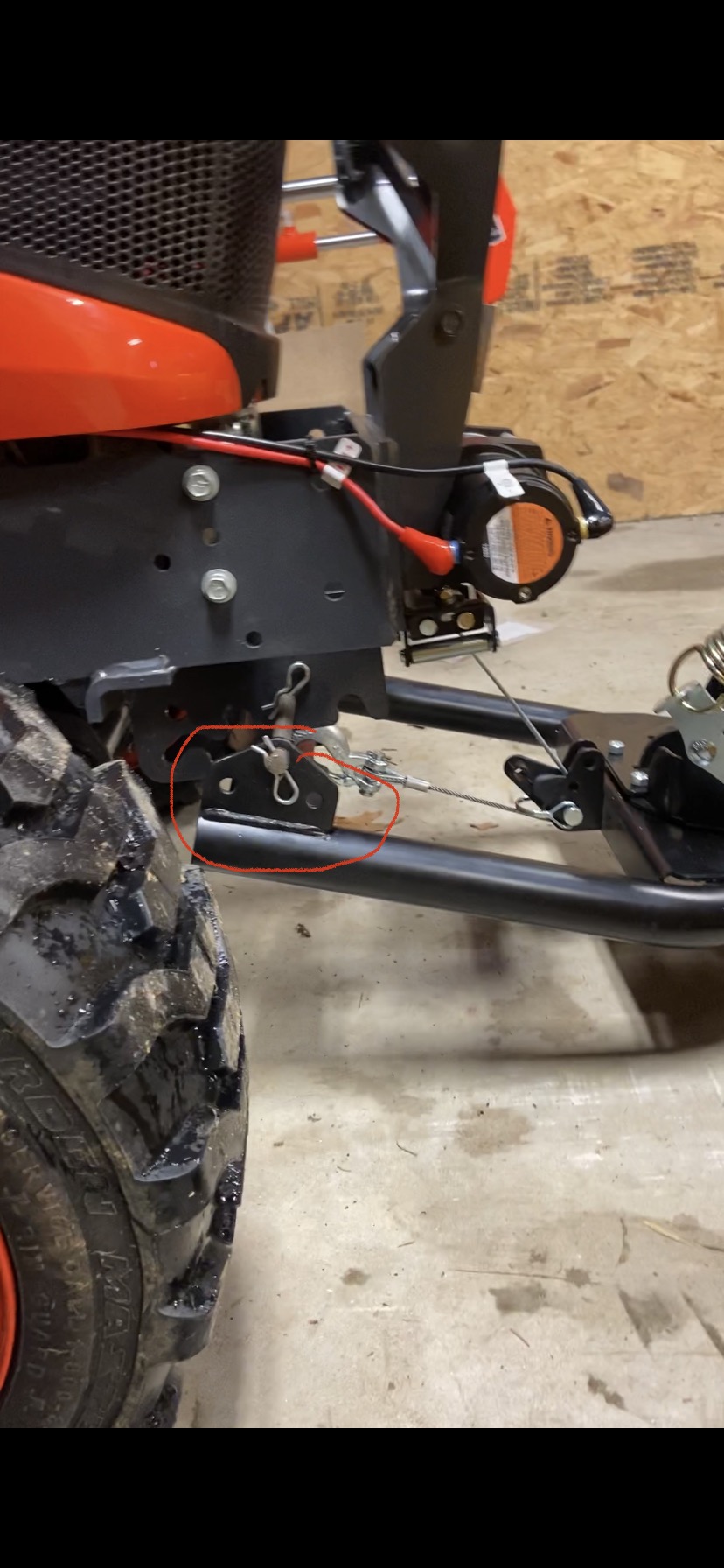

I mounted the winch facing down on 2 existing front frame holes. I drilled them up a size or two to fit my bolts. When it was mocked up I drilled two more holes to match winch plate, any universal winch mount can be put on front of bx. Ran my solenoid, wires and switch up right side to console and battery. Planning on cutting guage bezel to fit a standard utv rocker switch soon to make it cleaner looking.
I’m not sure of measurements but I took the 92100 to local welder was charged 40$, to move the tangs(ears that sheer pins go through) in about 3” on each side to match frame width of bx. and re weld them. Now take that mount and match up to existing holes under front of bx. You’ll see um. Throw the winch hook on it, and sheer pins and you’ve got a less than 700$ quick attach, angled snowplow setup that worked fantastic for me. Had 1 storm of 13” I had plowed and got hit again with another 10”. I was able to move the 3’ snowberm from previous plowjob to make room for new snow. It chooched black a little on final pass but I was pushing feet of snow. No chains, r4s. Combine that with 3pt blade reversing in tight spots. I enjoyed myself moving snow compared to bucket and rear blade. Loader clears winch, during off season.
Will get updated pics, Initially I tried running a bar and cotter pins before it snapped and that’s when I had ears moved inward and went to normal sheer pin.
