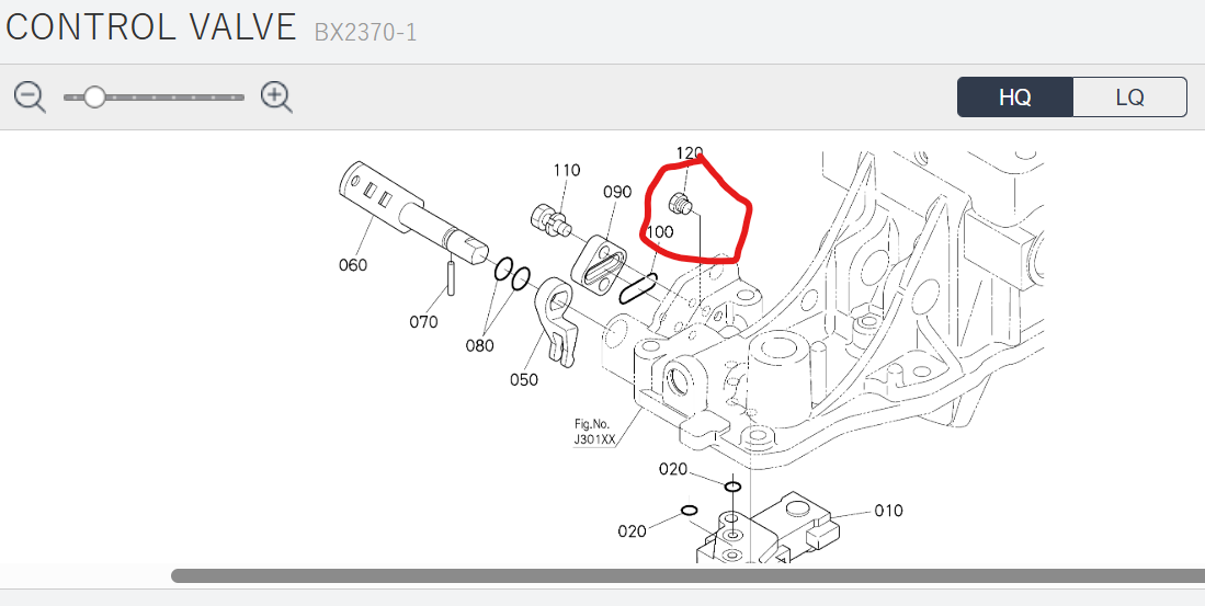

Curious, it kinda sounds like you're making a BX23S ?
Maybe look at BX23S parts online and use whatever Kubota used ?
Can we assume you'll use the BX23S BH mounting 'plates' ?

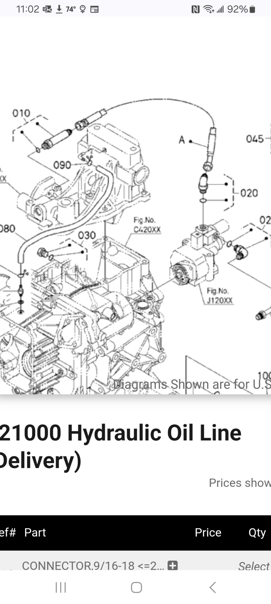

yes thats what I'm trying to do! I don't have any hydraulics in the back at this time!
On the BX23S the BT603 is actually the first device in the neutral circuit. It is fed by the hose coming off the pump and has a power beyond hose that feeds the inlet on the loader valve. You just need to break the BX2370 loader feed and add couplwrs for the BT603.
The BT603 also has a tank return hose that goes to sump at the same location as the loader valve. You will need to add a connection point with coupler for it.
