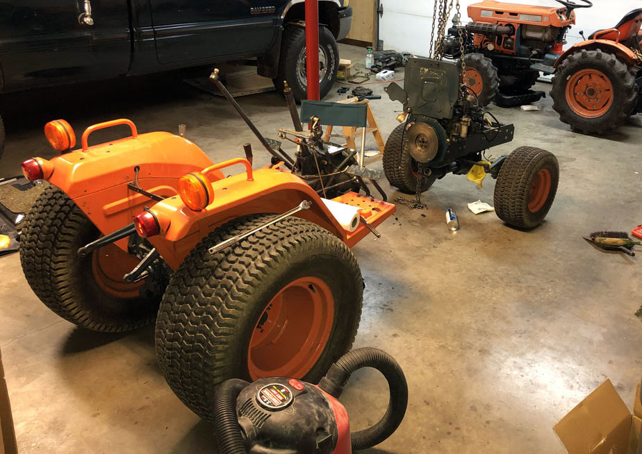

I replaced mine when I first acquired it. It wasn't too bad of a job. An overhead chain hoist really helped me out though!

I prefer the hoist method in my pic above. No need to block anything off. Plus, it's very easy to bring up or let down the engine. This is super helpful in lining up the dowl pins to get the two halvs back together. If you have a helper you may not heed it, but I flew solo on the clutch replacement.
