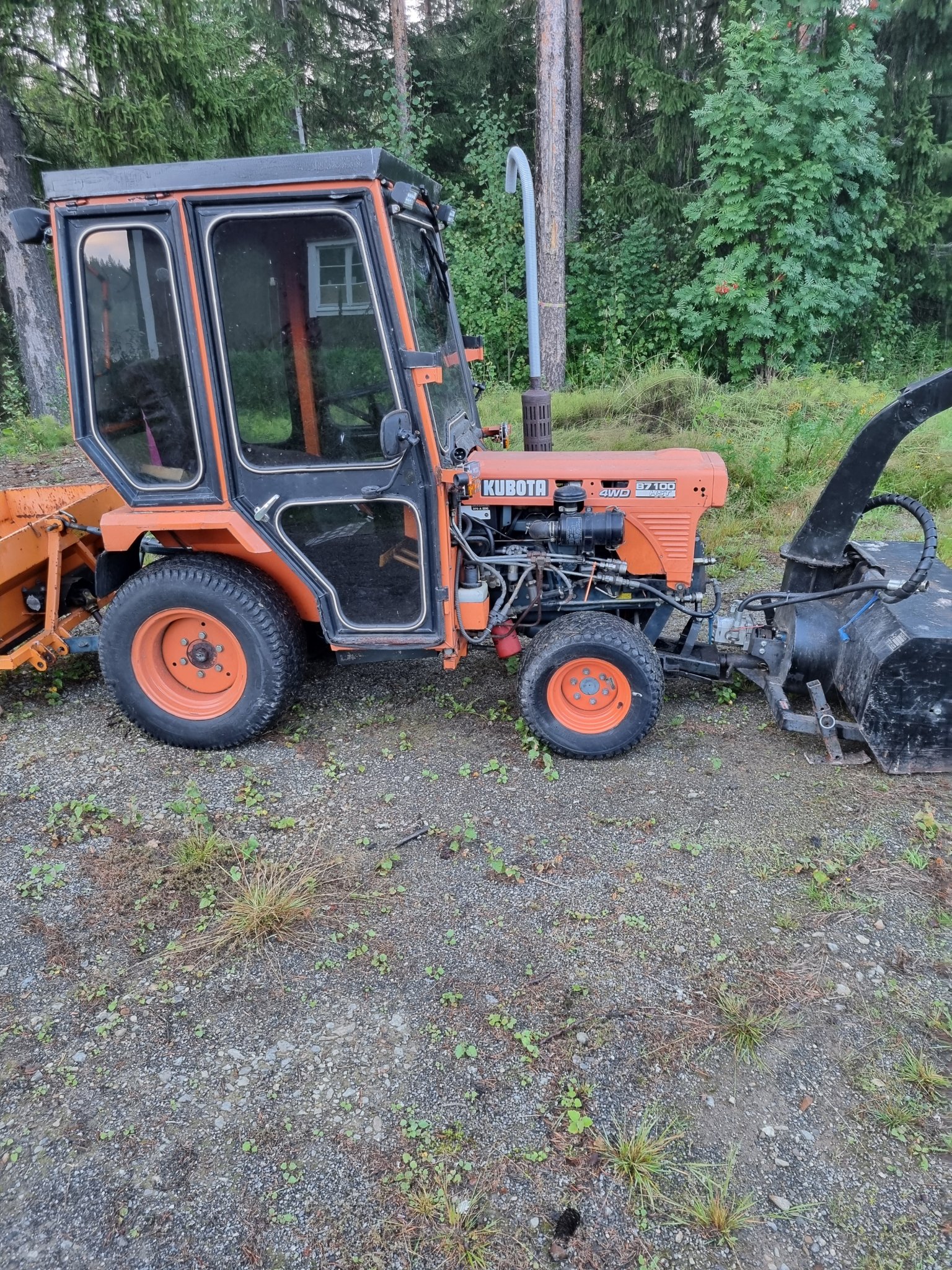

Been looking for a kubota b7100 HST or a similar model for months and months. Couple of weeks ago I finally found one near me in, what I think, pretty good shape (for being a 1985) with cab, cab heating, hydraulic front 2 stage snowblower and sand/salt spreader with "the right price" here in northern Sweden.

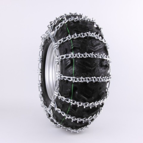

1. Chains
Is it right that you should always use chains on all 4 tires when in 4WD? And chains should be of same model/make?
I have been told those chains would be perfect for traction and steering, what do you think?

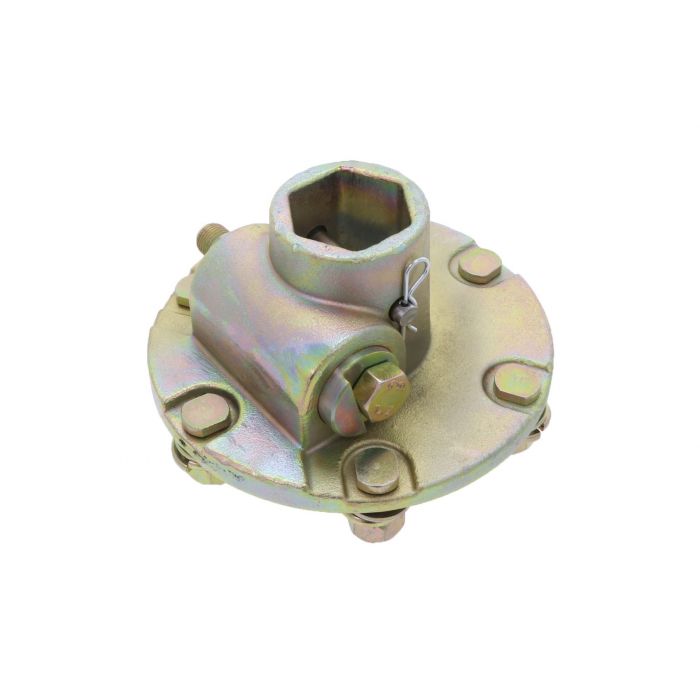

2. Rear wheel hubs
Does this looks to be same rear wheel hubs you guys think is a good choice? Its hard and expensive for me to order from US so this is the best I could find in Europe

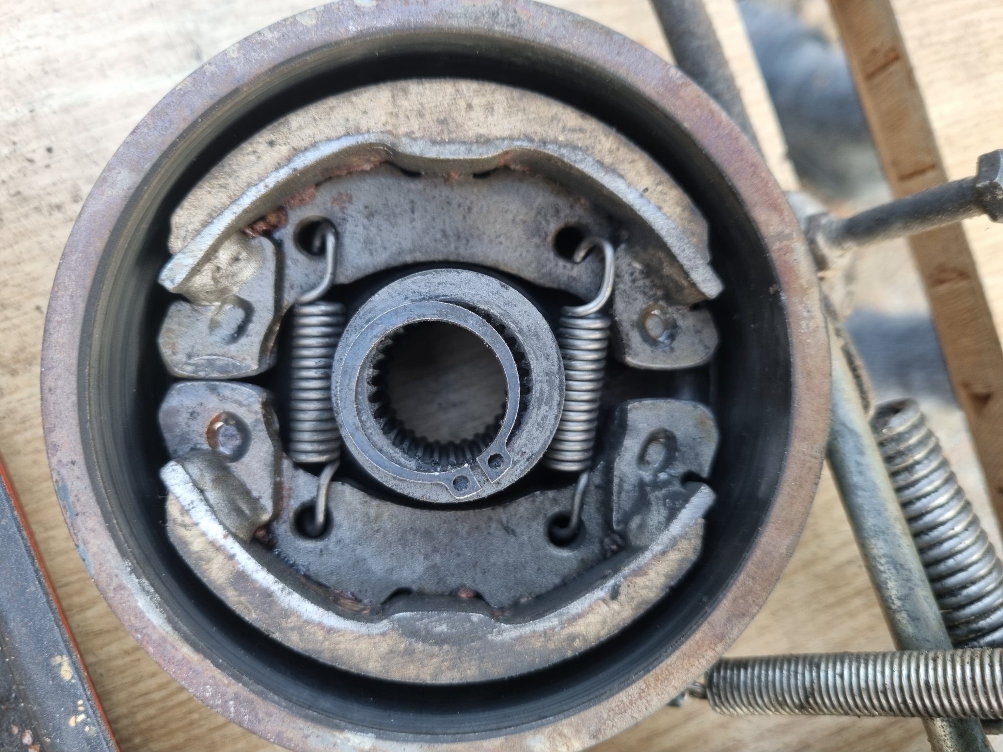

3. Brakes
What do you think about these breakpads, No need to order a new one right?

  1. I do not operate where it snows, but running in 4WD probably is a must for your conditions. Be aware that if the chains you add cause the rolling diameters to mismatch between the front and rear too much you can bind the 4WD system and cause problems. If you're off pavement and there is enough slip (probably a certainty in winter/ice/snow) then it should power through any mismatch.
  2. That is the "upgraded" wheel hub. It is plenty strong. Be sure to grease or put anti-seize material on the locking wedge mechanism so you do not get rust seizing it after a few seasons of wet and salt.
  3. The brake shoes appear to have good material. Clean, install, and adjust as appropriate.

4wd was definitely a must for me during winter! And this winter i will try out the chains too, not that it is absolutely needed but with a steep long driveway like this it will definitly help against spinning and sliding 😁
I will never use salt in the spreader, only 4-8 mm gravel/sand 🙂
Seller said those chain are ok regarding rolling circumference

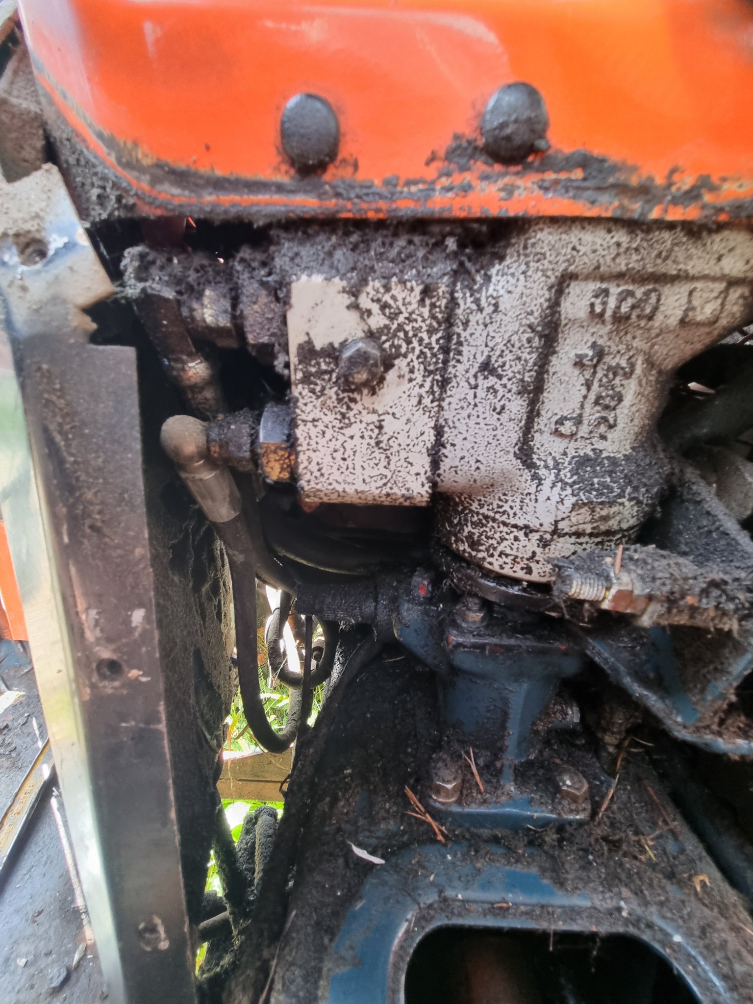

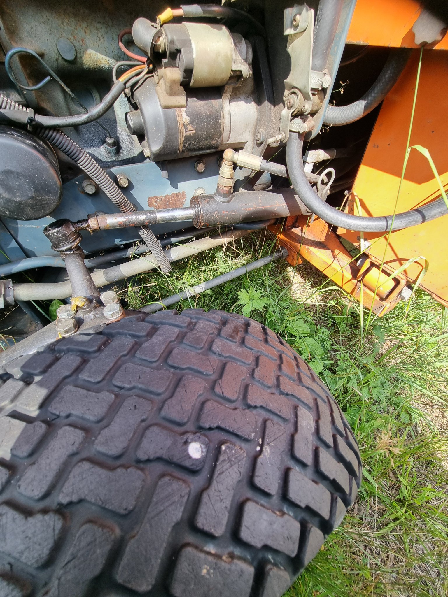

Sorry for all the dirt, first time opening up there 😀 Looks like something have been leaking 🧐
Iam gonna do a full service now which should have been done earlier
