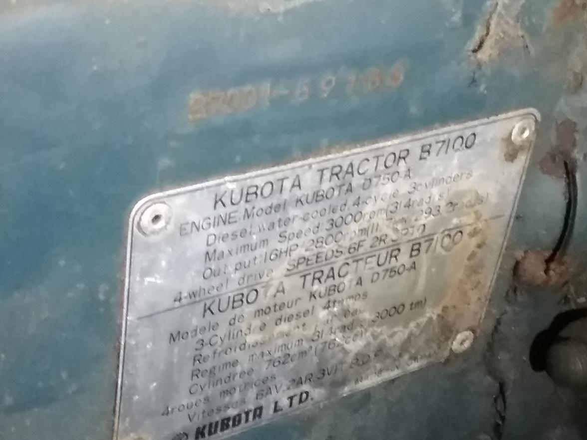

There is possibly a metal identification tag on each the side of the transmission. Posting that info will clarify what exactly your tractor is and approximately its age.
This is one of the two labels:
The other label will include the tractor's serial number.

I wanted to point out one oddity to these tractors, If you note the stamped number says B7001-XXXXX (where the X's are the serial number) yet we know that the other plate says B7100 and it is truly a b7100.
This is is a known quirk to these tractors, as the housings were all stamped with another tractor model #, yet the right serial # for the b7100.
