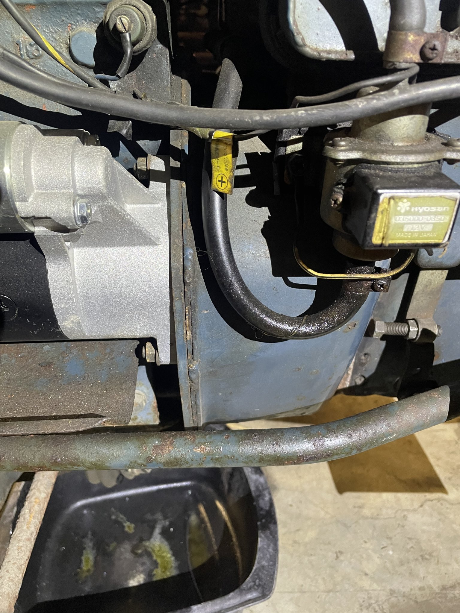

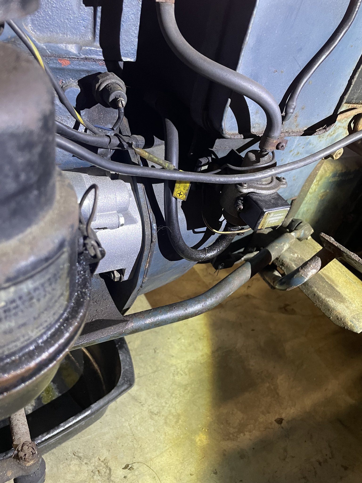

I have a gray market B6000. The transmission tunnel was previously cracked and repaired.
Anyway I’m looking to source a second hand tunnel. However it has eight stud mounts to the clutch plate whereas ones I have seen online etc have 15.
I’m guessing this is one of the changes in the gray market tractor. Does anyone know though if the 15 stud casing is interchangeable if I swap the clutch plate. Any other info

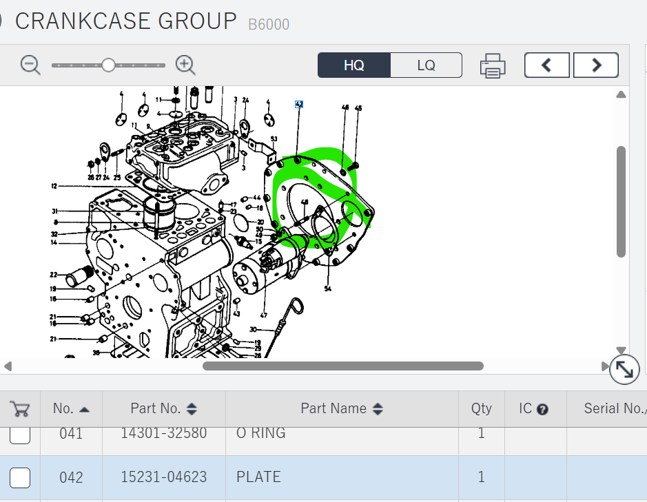

I suspect this plate is different and that would be about it.
But then when I count the motor mount holes on that plate has eight, I'm wondering if your looking at housings that have that plate included?
