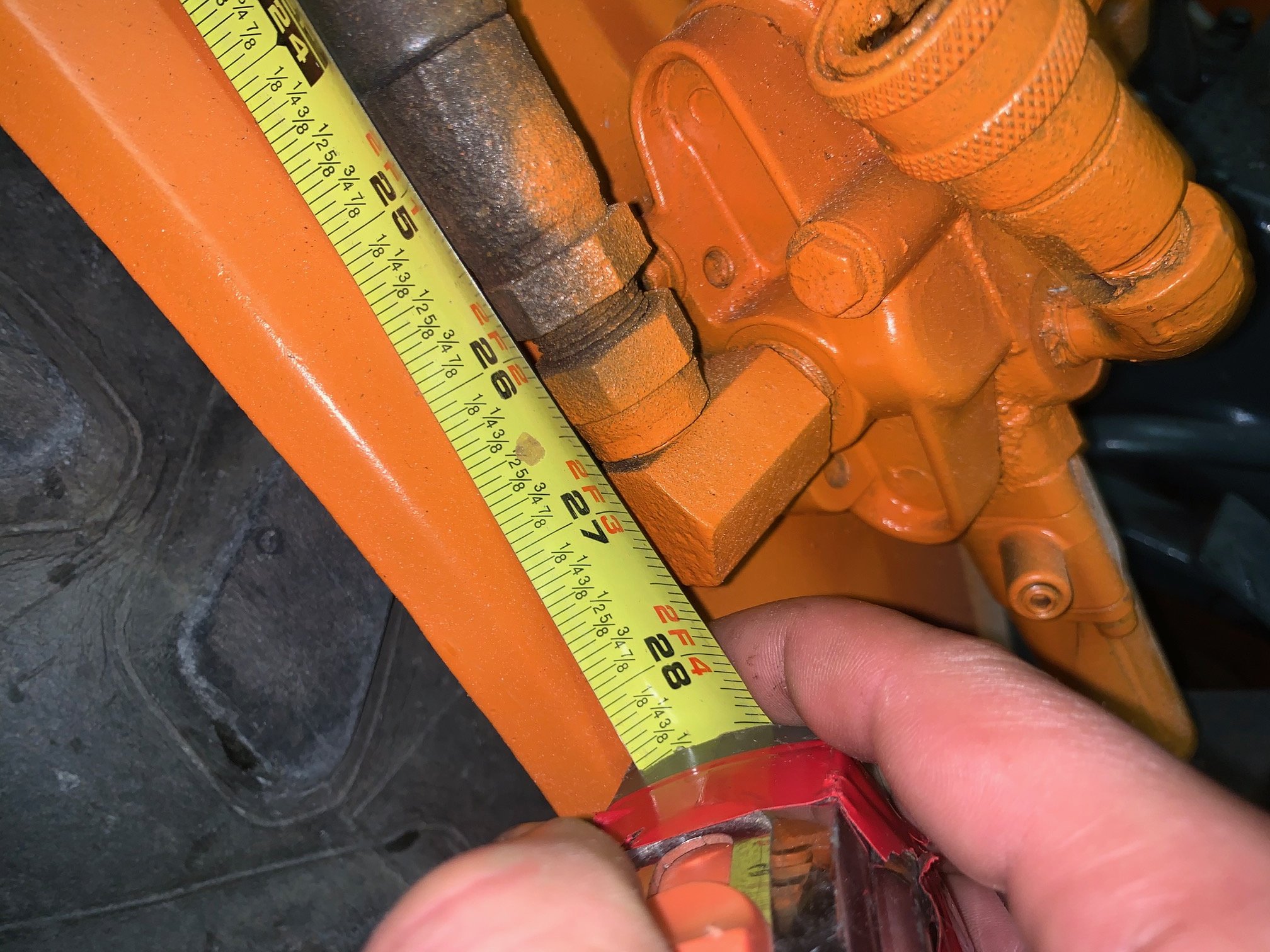

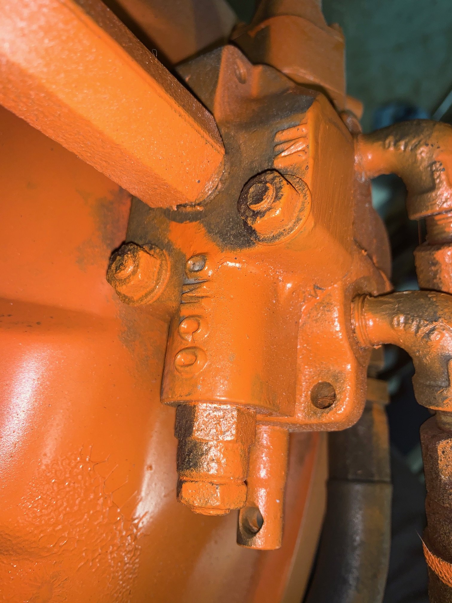

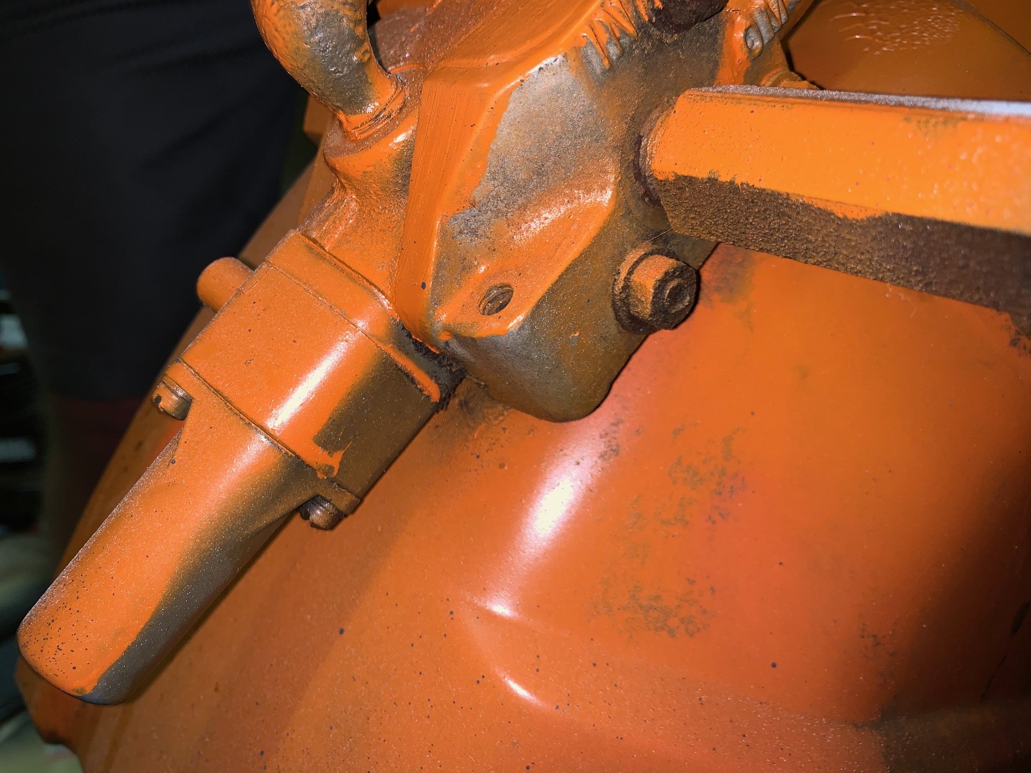

Ordering new lines and new quick connects for the tractor tonight and looking for some help on this distro block. Only thing I can find identifying it is that is made my OMCO ?
Any ideas folks?

That looks to me like a hydraulic control valve. It is missing the control lever.
I do not think it is a distribution block.
30,397
6,510
Yep what Kubota sam said, it's an aftermarket spool valve with the handle missing.
It's not going to work very well for any use without a handle.
