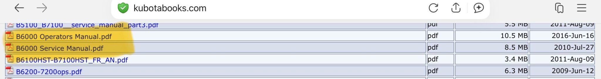

Hello, I wanted to ask about servicing my Kubota B6000 tractor. I just bought it and know absolutely nothing about it, so I want to change all the oils and filters it has (I don't know anything about them either). So I'm asking for help figuring out what filters and part numbers it has, what density and oil specifications to use, and which filter to change. Thank you so much, best regards.

I believe you can get to this site from your country. If not, tell us and someone can probably prove the manual in PDF format (language will probably be English and French). The site would like to get a donation but the do is free (don’t get caught up with a scam ad that may pop up)
