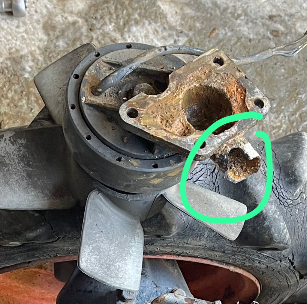

Hello, I'm having a problem with my Kubota B6000. It's not charging any current at the battery terminals. I've disassembled the dynamo and cleaned the magnet. Now I don't know how to check if it's working properly and can use a multimeter to check the three wires. I put a light bulb between them and it turned on, but I'm not sure if it's enough. If I can't fix it, I may have to buy another one. If you know of a purchase link in Spain, I'd appreciate it. It has corrosion. I've attached a photo. P.S.: In the photo, you can also see the block with signs of corrosion. There's a large duct on the left and a small one on the right. I don't know if this is the case or if it's clogged. Thanks for your help.

I think since it is corrodEd on that water connection point, AND it is not charging you might be better off replacing it if you can find one.
@Mountainman runs this salvage yard and I think I have seen statements that he ships worldwide. I think you may be able to get one from the Kubota dealer in Spain or Europe but no idea who

Thank you sir. I do ship worldwide but unfortunately don't have a b6000 dynamo right now. Hard to come by these days
