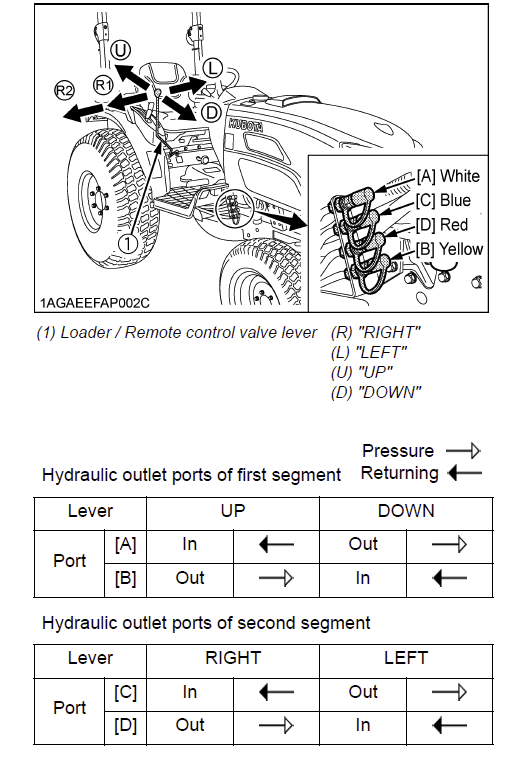

After removing the snowblower and reinstalling the LA534 loader on the tractor, the bucket ‘Dump and Curl, function only moves the bucket about 15 degrees total.
I have tried a few combinations of hydraulic line connections, but the bucket ‘dump and curl’ is still not working.
The boom is working fine from ground level to maximum height.
Might this be a mix-up in the loader to tractor hydraulic connections?
Any help would be appreciated.

Almost surely misconnected hoses.
Dustball
2016 B2650HSDC
Sep 15, 2023
393
250
Hudson, WI
A and B are for the loader cylinders.
C and D are for the bucket curl cylinders.
