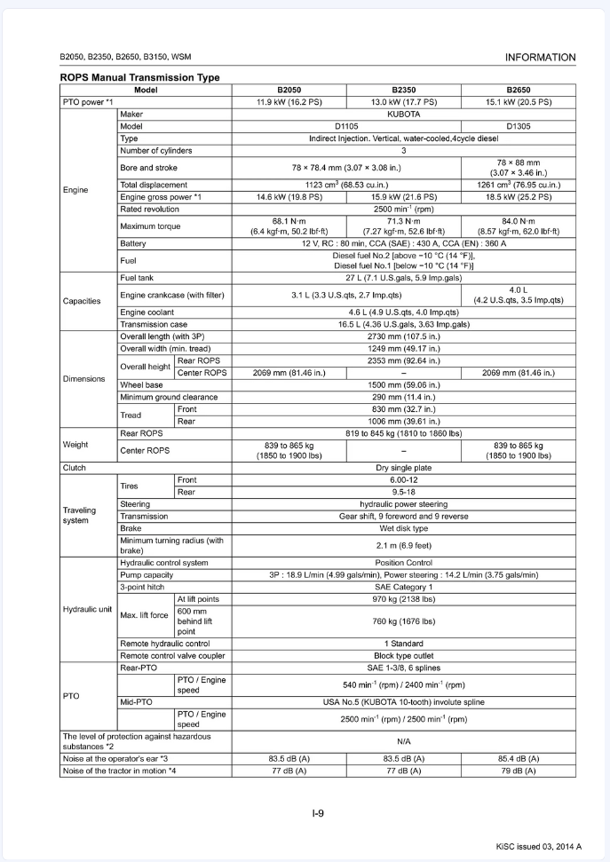

He's in Portugal, B2650 (no HST or HST) may be a thing there?
This WSM page screenshot shows a manual tranny B2650 ROPS variant:
From https://www.slideshare.net/slideshow/kubota-b2050-b2350-b2650-b3150-service-manual/215876317#6
Must be a non-USA model. There is a WSM at www.kubotabooks.com. There are models with independent PTO with hydraulic clutch and mechanical PTO with manual shift. I assume OP's is the latter. If so, there appears to be some external linkage that could be out of whack. Wishing OP good luck.
