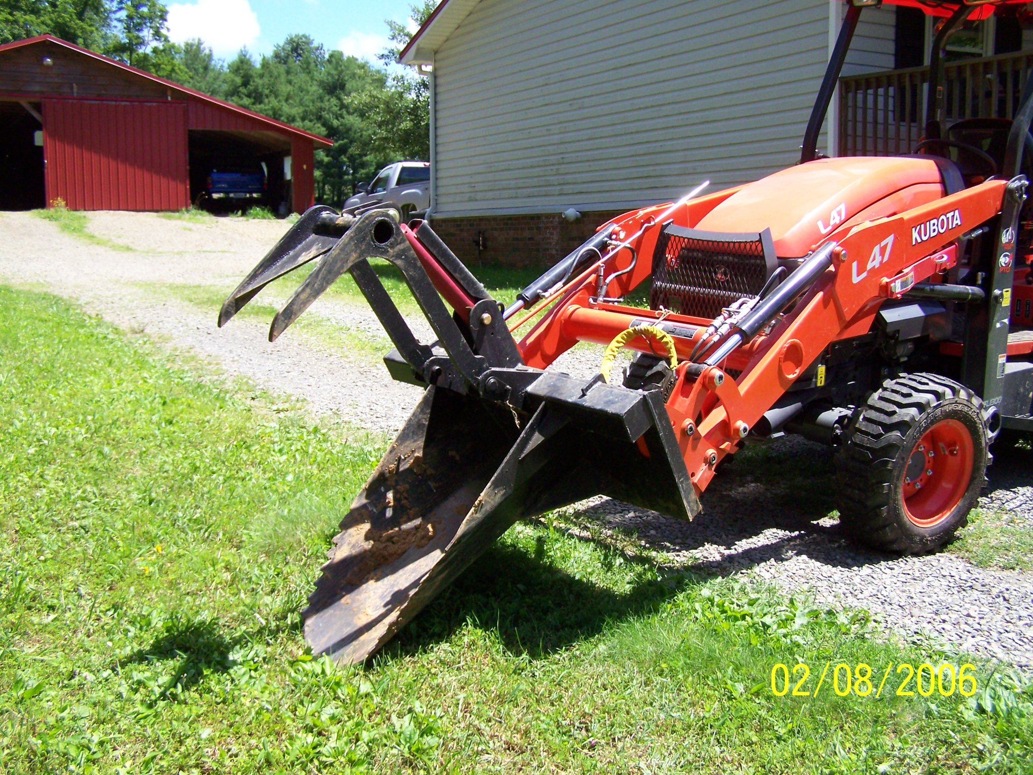

I don't know how well a stump bucket will work on your size tractor.
I bought one from Mid-State Equipment with a grapple. The grapple option works great. I've owned round bottom and flat bottom stump buckets. The round bottom models seam to penetrate the ground easier.

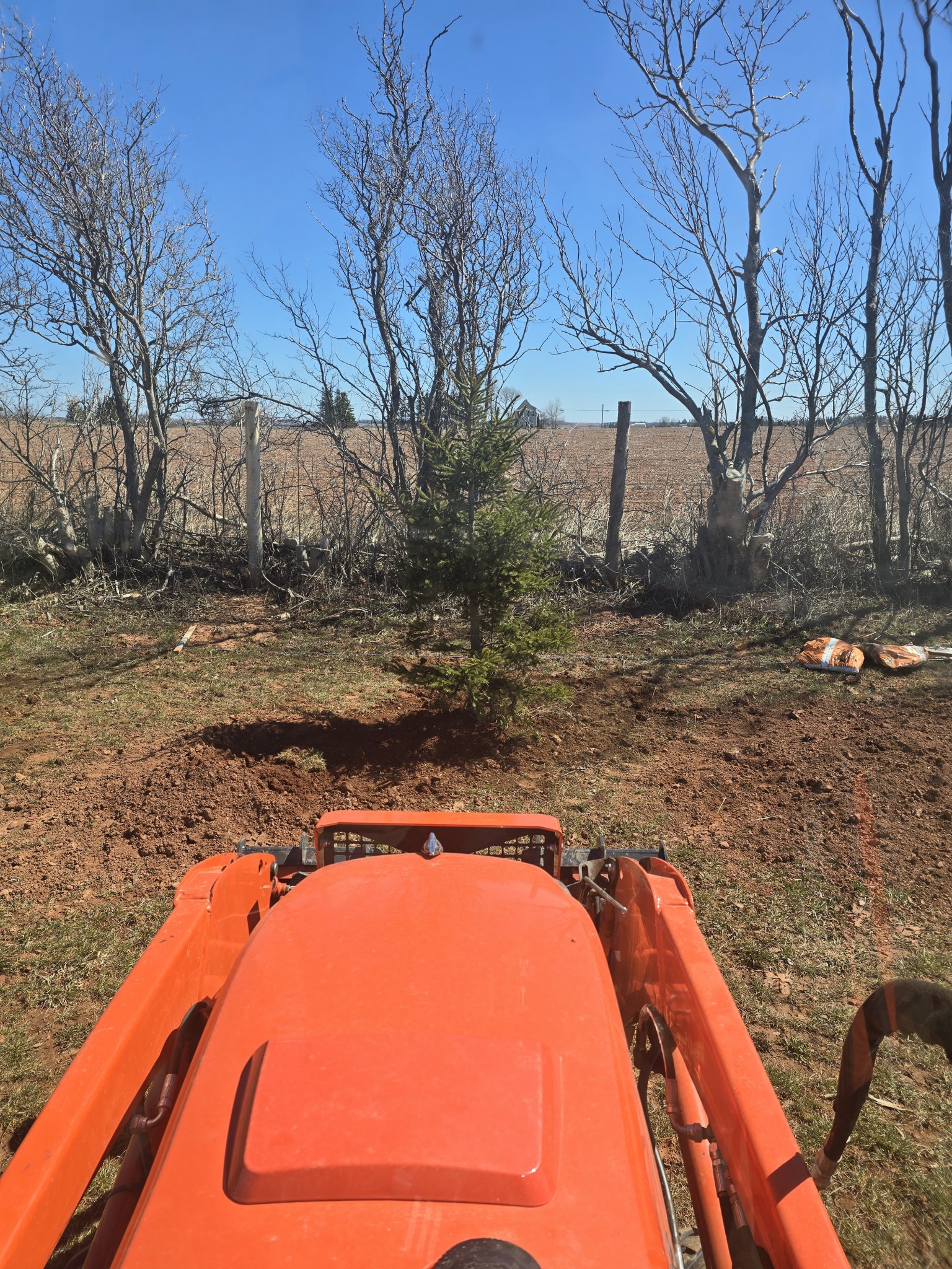

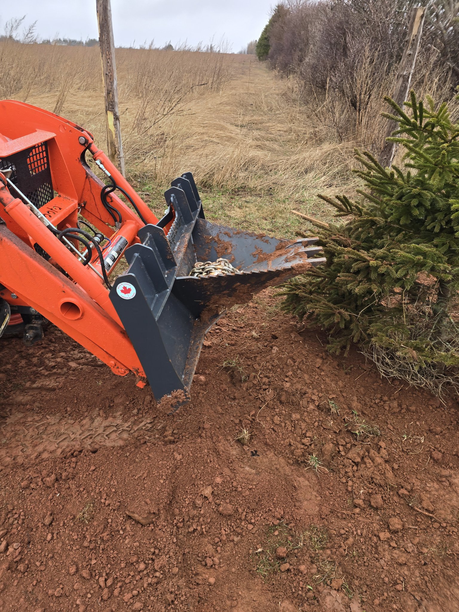

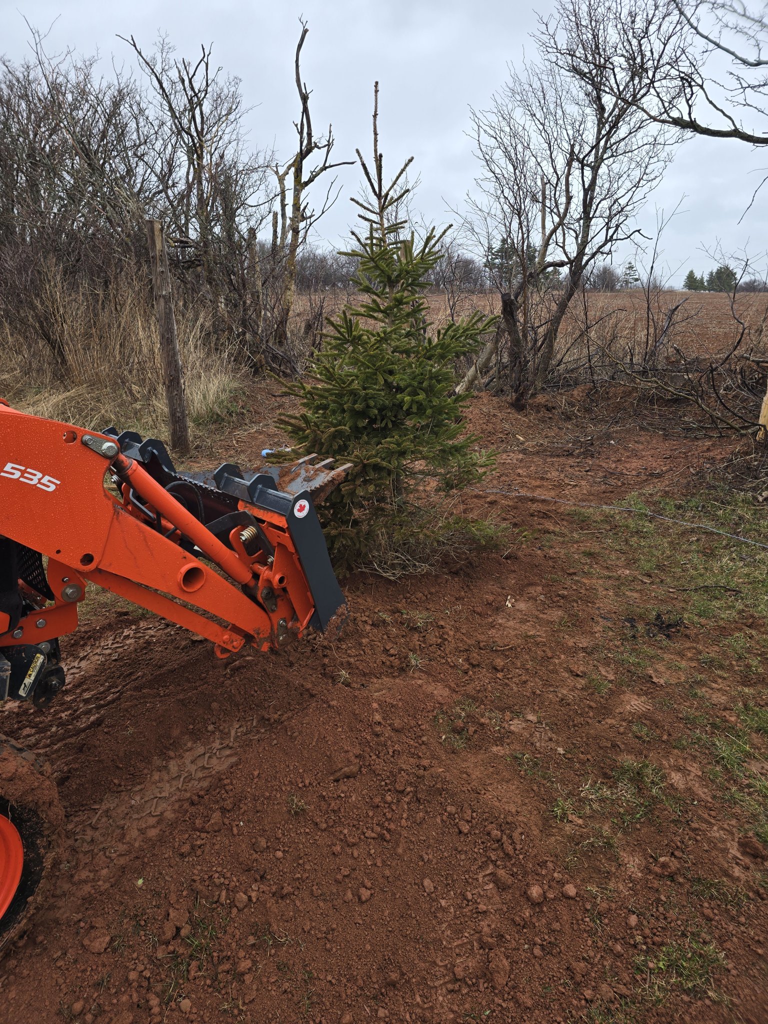

I bought a 21" stump bucket from https://www.farmerequipmentsales.co...t_in_universal_skid_steer_quick_attach.html#/ for my LX3310.

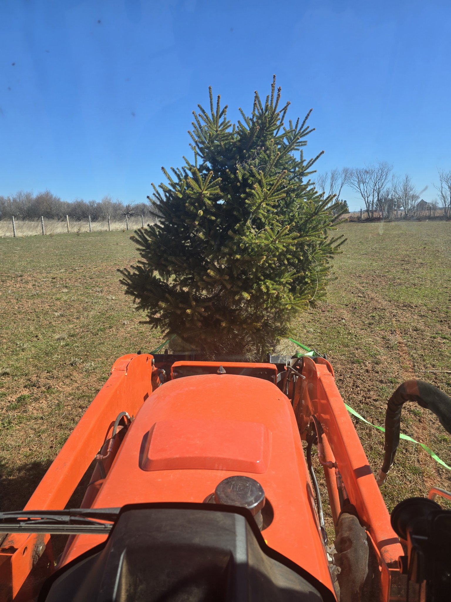

I moved around 45-50 spruce trees averaging 8' tall. There was a bit of a learning curve to use it because it is hard to see the end of it from the cab. Once I had the tree out I used a rachet strap to hold it in place for transport to the new location at the back of my property.
A longer version would be easier to see but I'm not sure how well the tractor would handle the bucket.
