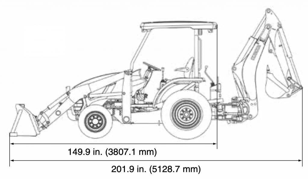

Hey folks, there are some different numbers coming up on the google machine but can someone pull a clear measurement for me here?
I'm looking for a length measurement of the B26 TLB with the loader and BH attached, the loader down and the hoe curled in to the shortest possible length.
That would be of huge help, thanks a ton.

Attached below is a snapshot from the B26 brochure of the length. The brochure is available BY CLICKING HERE and that snapshot was taken from the top of page 15.
