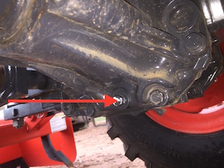

The manual shows three drain plugs for the hydraulic/transmission fluid but there are four drain plugs. The two drain plugs on the rear axle that the manual shows are incorrect.
Following are the four drain plugs.
First one is near the PTO underneath the tractor. Photo 1.

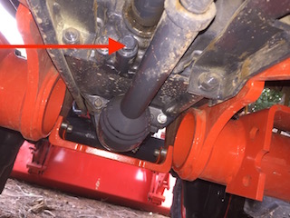

Second drain plug is on the right rear axle. Photo 2.

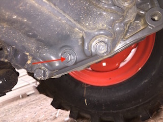

Third is on the left rear axle. Photo 3.
