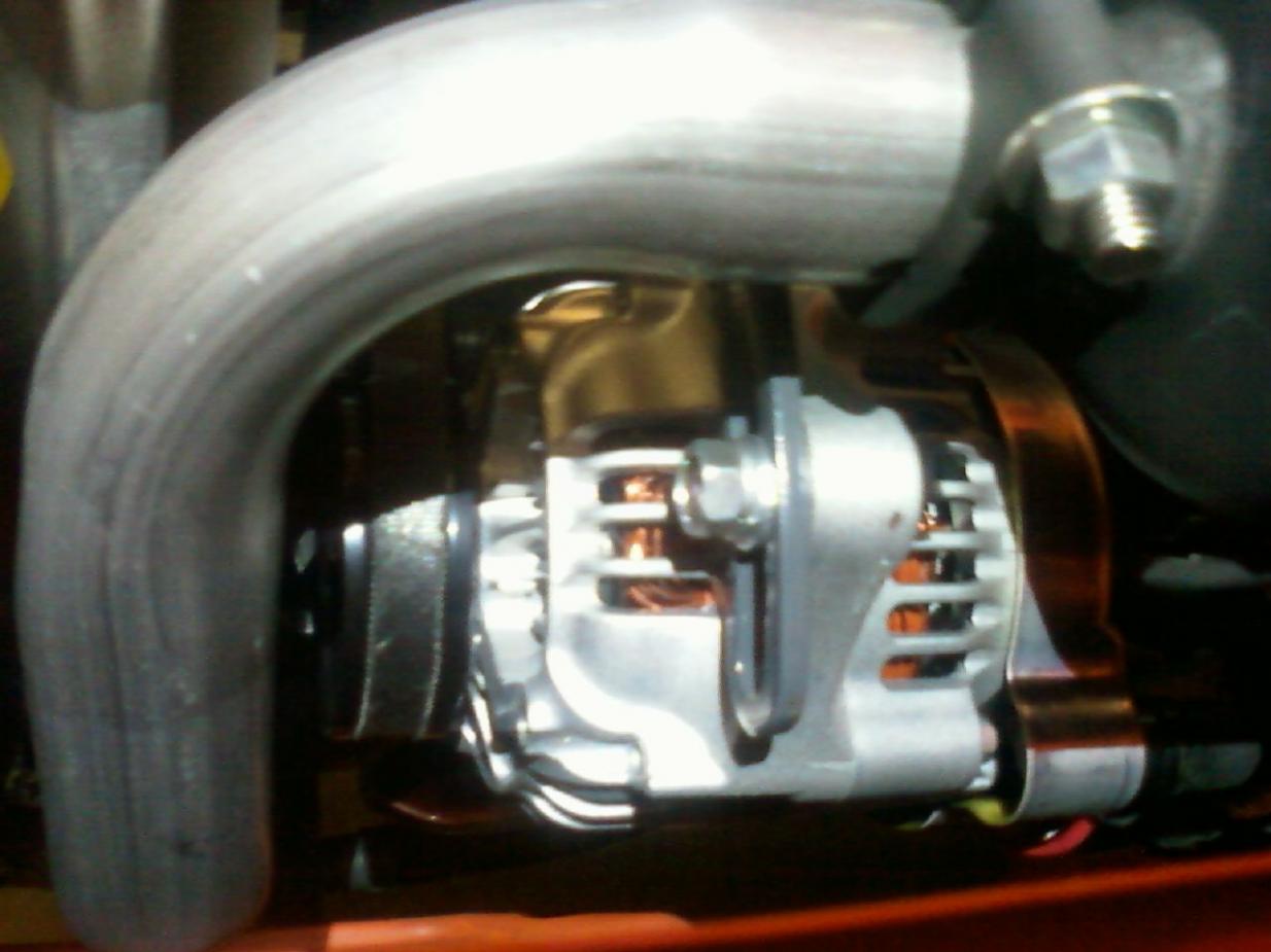

I got my upgraded alternator upgrade kit installed. I now have 40 amps to work with on tractor lighting! The orIginal equipped dynamo 14 amp charging system with a external recitifer/regulator is long gone for this rig, bad bad idea on the dynamo!!!
