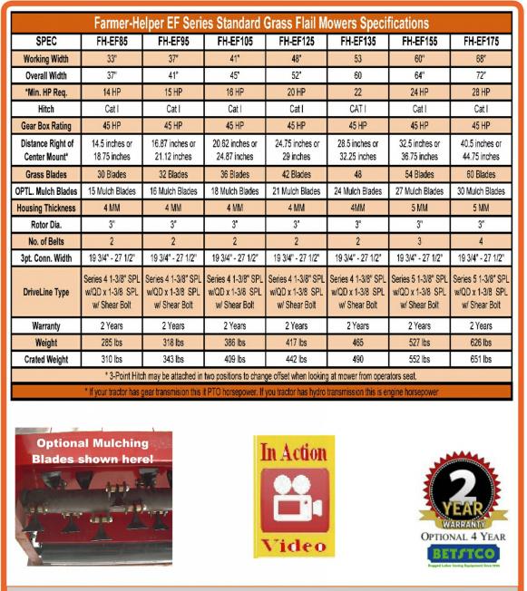

Ok, so I am about to make a final decision on a flail mower! I have been researching, calling around etc. The Betstco /Farmers-Helper is the best priced, imported from China assembled and sold out of Oregon. Haven't heard anything bad about them.
My Kubota B20 has 20HP engine, 13.5HP PTO and is 48" wide. Been trying to decide between a 41" (16HP required) and 48" (20HP required).
The specifications state that, for the HP requirement ,"If your tractor has gear transmission this is PTO horsepower. If your tractor has hydro transmission this is engine horsepower"
Based on this, it sounds like I am within spec for the 48". I realize I am at the limit and will need to go slow for high brush but am thinking this is my best option.
I plan to order it next week, and will be monitoring this thread until then. Ultimately I will post my results once I receive install and use it.
